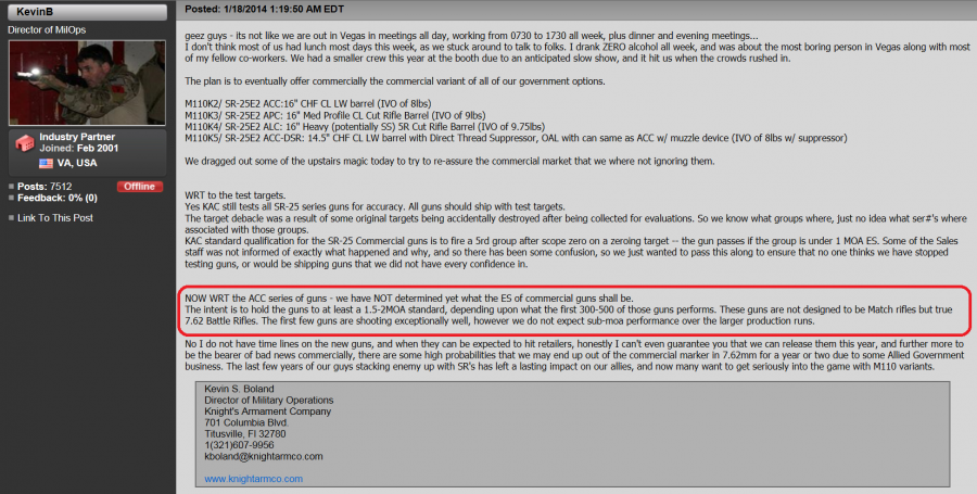

BLKSHEEP Posted March 21, 2015 Report Posted March 21, 2015 (edited) Straight from the horses mouth, 1.5" - 2" MOA. http://tinyurl.com/k2jdt3w Edited March 21, 2015 by BLKSHEEP
FaRKle! Posted March 21, 2015 Report Posted March 21, 2015 Straight from the horses mouth, 1.5" - 2" MOA. http://tinyurl.com/k2jdt3wOn that note, what do the test targets that shipped with the guns look like?
Bad Wolf Posted March 21, 2015 Author Report Posted March 21, 2015 "NOW WRT the ACC series of guns - we have NOT determined yet what the ES of commercial guns shall be. The intent is to hold the guns to at least a 1.5-2MOA standard, depending upon what the first 300-500 of those guns performs. These guns are not designed to be Match rifles but true 7.62 Battle Rifles. The first few guns are shooting exceptionally well, however we do not expect sub-moa performance over the larger production runs." -Kevin from KAC. I guess this says it.
