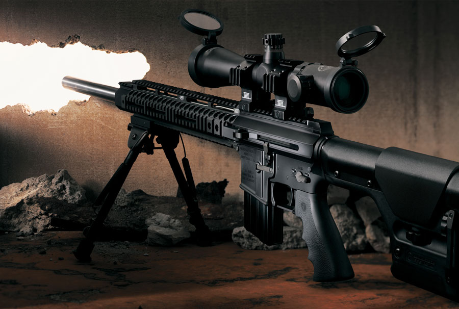

elkbow Posted February 13, 2012 Report Share Posted February 13, 2012 I would also stick with the POF upper, that way you know the fit will be good.Below is my POF P308, this a factory gun, 16", no mods other than working the trigger over. On my POF's I normally don't like the trigger, however they can be given a little work and are pretty good. Quote Link to comment Share on other sites More sharing options...
