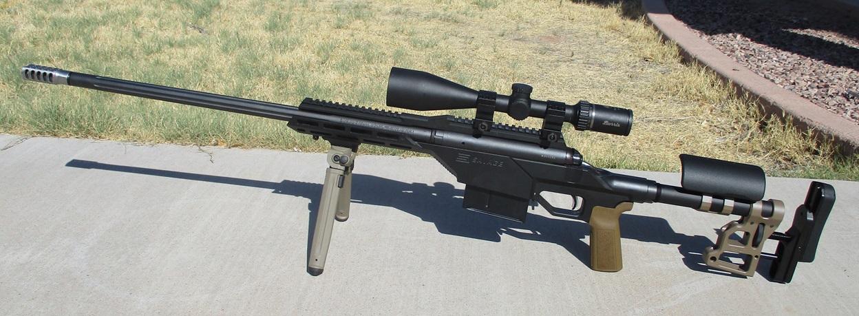

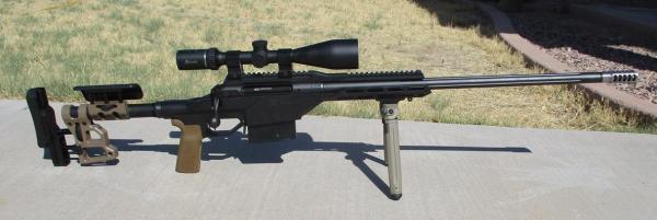

Finally got one.  This is a Savage 110 BA Stealth model.  They introduced it around 2017, and discontinued it when they came out with @Magwa's model.  First time, on this model, that they blueprinted the action.  Has the Savage Accu-trigger, which I'm a huge fan of, and it comes in the MDT LSS chassis.  24" barrel.
Witt Machine brake went on it as soon as it came home.  Don't really like the glass I got with it, so that's coming off, as well as those ridiculously high rings.  The scope was ordered, and is in at GunPusher John's, going with the Athlon Ares ETR Gen 2 UHD scope, 4.5x ~ 30x.  Getting mounted in Burris XTR Signature rings.
Shot it last weekend, kicks like a MOFO, because it's light.  The stock it came with sucked, so that's gone.  MDT Skeleton Carbine Stock already on it, and some MDT chassis weights on the way now.  Beef this thing up al little, drop the recoil.
Enough talk - here it is right now:
