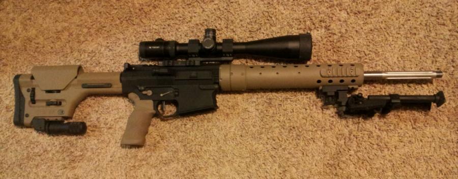

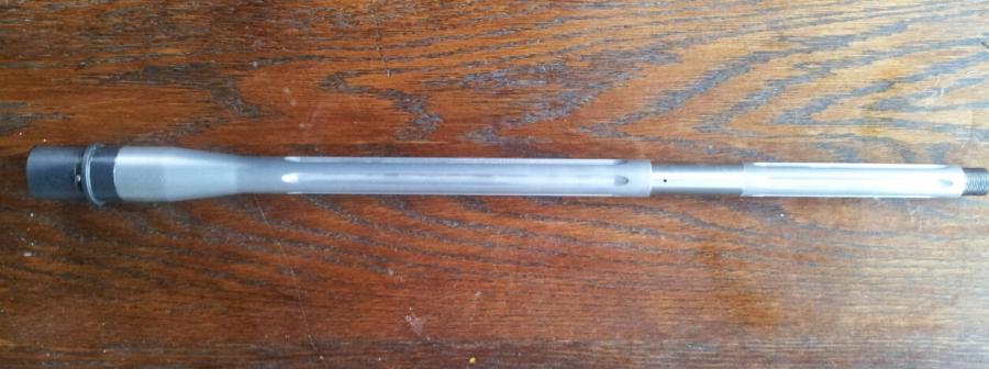

MONTANA308 Posted May 5, 2013 Author Report Share Posted May 5, 2013 Megowen precision barrel 20IN 1/10 twist fluted. just have it mocked up in the rifle going to try get it put together tommorrow night. Quote Link to comment Share on other sites More sharing options...

MONTANA308 Posted May 6, 2013 Author Report Share Posted May 6, 2013 Thanks guys be glad when I get it all done so I can start working on my next build. I was greatly pleased how well balanced the gun is. Now I gotta figure out what brake I'm gonna run Quote Link to comment Share on other sites More sharing options...
MONTANA308 Posted May 7, 2013 Author Report Share Posted May 7, 2013 Ok I'm going together with my build got barrel nut lined up perfect. Torqued it to 47 lbs when It lined up perfect. Also got gas block on. You guys got any tricks of the trade or anything I should know before I say am actually done? Quote Link to comment Share on other sites More sharing options...

MONTANA308 Posted August 6, 2013 Author Report Share Posted August 6, 2013 Well I've finally got this gun up and running first twenty rounds was all on adjusting gas block and getting her to feed. had her dripping wet but still wouldn't pic up a round. Or it would work perfect for three and then FTF. I ran out if daylight so put one more round through to try NEMO Arms flash hider. It's good at it's job. Took it home and covered the BCG in mil comm TW 25B and sat in my chair and worked the old pull to start for an hour or . did this for a couple days till I could shoot again. Next 25 round gun ran flawless. Will be working on some handloads to see how tight she will go. Was using some magtec 150 fmj at 2800 and it shot well but not great I'll keep ya posted on progress so far I am very happy with my build Quote Link to comment Share on other sites More sharing options...

MONTANA308 Posted August 15, 2013 Author Report Share Posted August 15, 2013 Took my rifle to my buddies 1000 yard range this evening.did a little little zeroing work then went out to 500 meters I was shooting some magtec 150 fmj. We are shooting at a 16in steel disk. Put few rounds on the steel. Probly would have put more on but the fmj where going right through the steel target and we making adjustment not knowing they where punching right through. Gun ran flawless again anther 20 rounds down range. We also worked on his GA Persion 6.5 creedmore bolt gun put three rounds in the center and a little left on the same 16in Steal disk at 900 meters. Was a good day at the bench. Quote Link to comment Share on other sites More sharing options...
