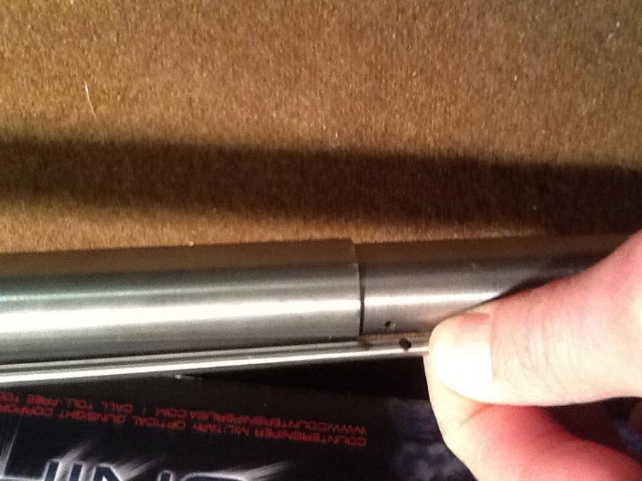

Tritondavey Posted December 20, 2013 Author Report Posted December 20, 2013 Lilja won't take the barrel back. This is a picture of how far off it is. This is the position when the bolt is fully closed. When I install the gas tube and block and line up the hole in the gas tube and barrel then the bolt is slightly open which of course won't allow the weapon to fire. Can I just have the existing hole in the barrel plugged and re-drilled by a gunsmith? Or would it be better to see if a DPMS gas tube that is short work? Thanks

survivalshop Posted December 20, 2013 Report Posted December 20, 2013 If the 15 1/2 " gas tube is keeping the BCG from locking into battery , I would get the std AR 15 rifle length gas tube . I don't need the one I have if you want it . Shipping it now would be crazy , but I will if you want it , just PM me . I believe we had a similar issuer not to long ago with the opposite situation , the posters tube was too short & he went to an armilite tube to make it right . No photo is seen, as said, but I get what your are talking about.

Tritondavey Posted December 20, 2013 Author Report Posted December 20, 2013 Sorry, here is the photo. I have ordered a shorter gas tube and hope that will work. I'm nervous about cutting this tube and trying to duplicate the proper flange. I appreciate all the help and suggestion. I will let everyone the outcome
Dane Armory Posted December 20, 2013 Report Posted December 20, 2013 That's. Not the photo we what. I described the photo needed... Please assemble your rifle in that way and take a picture of the upper with the gas tube installed. A ruler next to the groove area of the upper would help. Thanks
