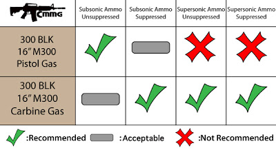

Blondielocks Posted March 31, 2014 Report Share Posted March 31, 2014 Part Two Finished up the rest of the 300AAC subs I had, a little over 100 rounds. Hiccups worked themselves out after the 1st mag today, kept everything oiled and everything ran like clockwork (except the 20 rounds of crappy reloads from my buddy). I think there's something to be said about using the pistol length gas system that allowed it to fire subs unsuppressed using the 14.5" barrel. Pretty happy with the MAS Defense barrel for what I paid for it; groupings were tight and consistent (averaging around 1.5" at 100 yds). This is probably the easiest gun that I've shot ever. Next time for my own reloads. Scored some 208gr A-Max yesterday at sportsman's. Gonna see how they do with the recommended AA1680 powder..... I so need to get a chrono. -S (Tom posting) Brother, you haven't been listening to me from the beginning. Here's what's to be said for pistol gas and subs, unsuppressed: Quote Link to comment Share on other sites More sharing options...
shibiwan Posted March 31, 2014 Author Report Share Posted March 31, 2014 If it can fire subs, it can fire supers. Problem solved. :D :D :D Quote Link to comment Share on other sites More sharing options...
