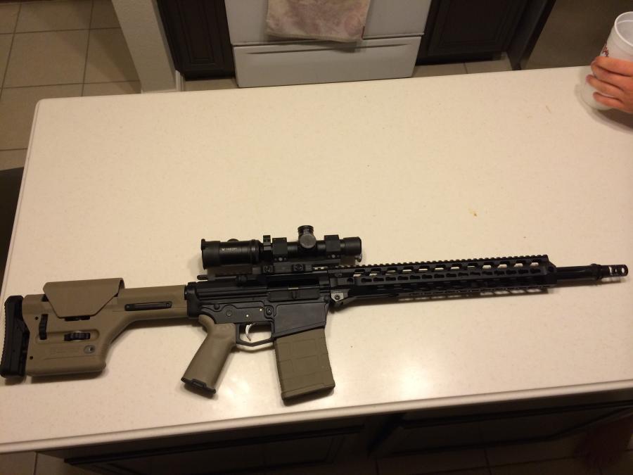

Clay_FortWorth Posted June 7, 2014 Report Posted June 7, 2014 Hey Guys, New to the forum. Buddy and I are building our first AR308. Still building it and have not fired it yet. We ordered a TM10 lower and a CMMG LPK. Installed the bolt catch and it didn't feel right. Pin was stuck so based in internet research grinding it out with a dremmel seemed like the best course of action. Got the pin out and replaced the bolt catch with a DPMS bolt catch. Just operating it without the upper feels way way better and correct. ***PROBLEM: reassembled the rifle I am have trouble locking the bolt the rear. It seems like it is not engaging enough and when It does I have to work at it to lock back. Has anyone run in to this problem? I inserted a mag and the bolt will lock back, but if i remove the mag it sends the bolt home into battery...... Too sensitive for me. I am still waiting for our bolt to come in from Shadow Ops weaponry so I have been using a bolt out of another buddies DPMS Sportical. Maybe this could be the issue? TM10 Lower DPMS LR308 upper DPMS 18" SASS barrel Fortis Switch 14" Magpul PRS ALG ACT trigger Shadow Ops Weaponry Bolt A2 rifle buffer from Brownells AAC muzzle brake Added a photo below of the rifle assembled so far Thanks guys! Clay

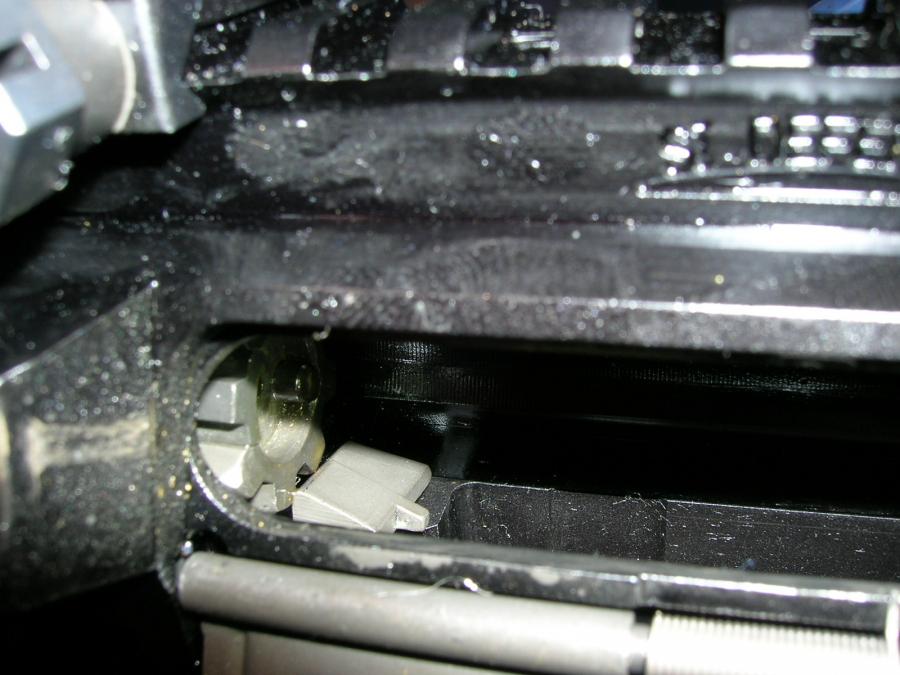

shibiwan Posted June 8, 2014 Report Posted June 8, 2014 Take a pic of the bolt catch area and lets have a look. CMMG had installed the wrong bolt catch in my rifle... they did make it right by sending me the right one. This was the wrong bolt catch in my rifle.

Clay_FortWorth Posted June 8, 2014 Author Report Posted June 8, 2014 (edited) Here you go Shibiwan: (took me a while to figure out how to upload the pics) Edgecrusher: I will check those out as a replacement if it is indeed the bolt catch needing to be beefed up. Washguy: Supposedly it would just slide out but it was stuck so I grinded out a hole to work the pin out with a small slot screwdriver. Edited June 8, 2014 by Clay_FortWorth

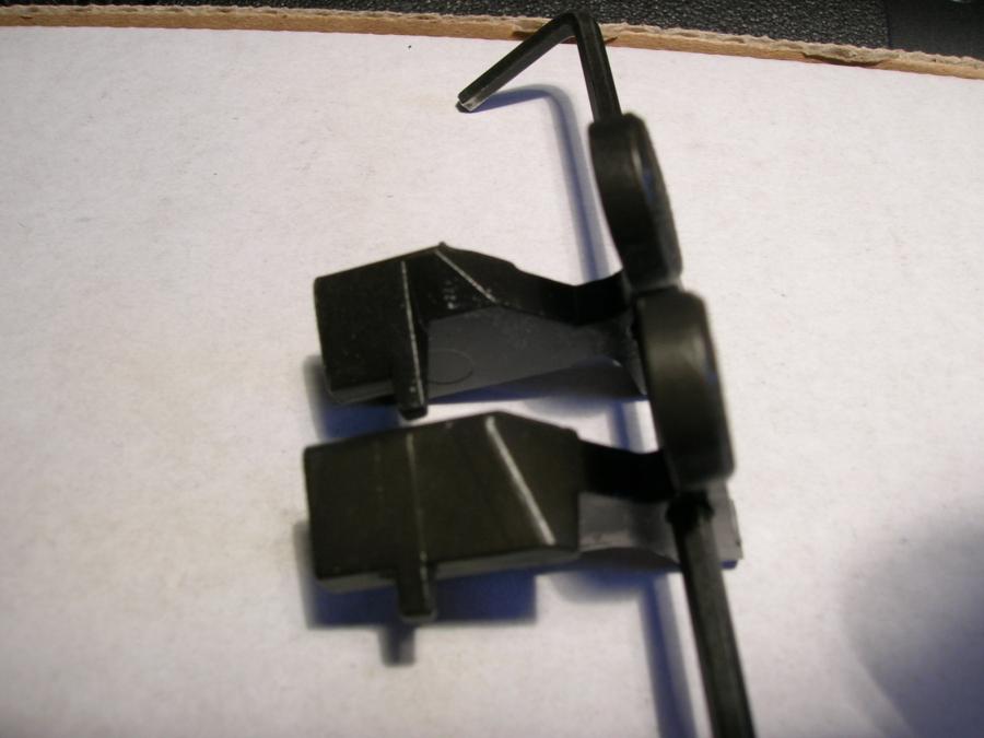

survivalshop Posted June 8, 2014 Report Posted June 8, 2014 (edited) First off , the pin is hardened steel , if I remember correctly & if you over tighten the set screw or securing set screw , it will force the pin into the far side of the receiver . I would install the pin & use a removable loc-tite, like the Purple or a very ,very small amount of the Blue & lightly set the set screw . Making sure the pin is supported on both ends in the receiver . As said by 98, make sure you use all 308AR receiver extension components. Make sure you don't have a AR 15 bolt catch , you need an 308AR bolt catch , below show the difference. Yours looks like the right one. Also make sure there is easy freedom of movement with the catch & its not hanging up. I have also had to make adjustments to the the Bolt catch to let it rise farther to engage the bolt . Edited June 8, 2014 by survivalshop
