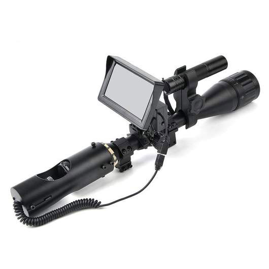

mrmackc Posted September 7, 2020 Report Posted September 7, 2020 Anyone ever used one of these night vision things on your riflescope?
