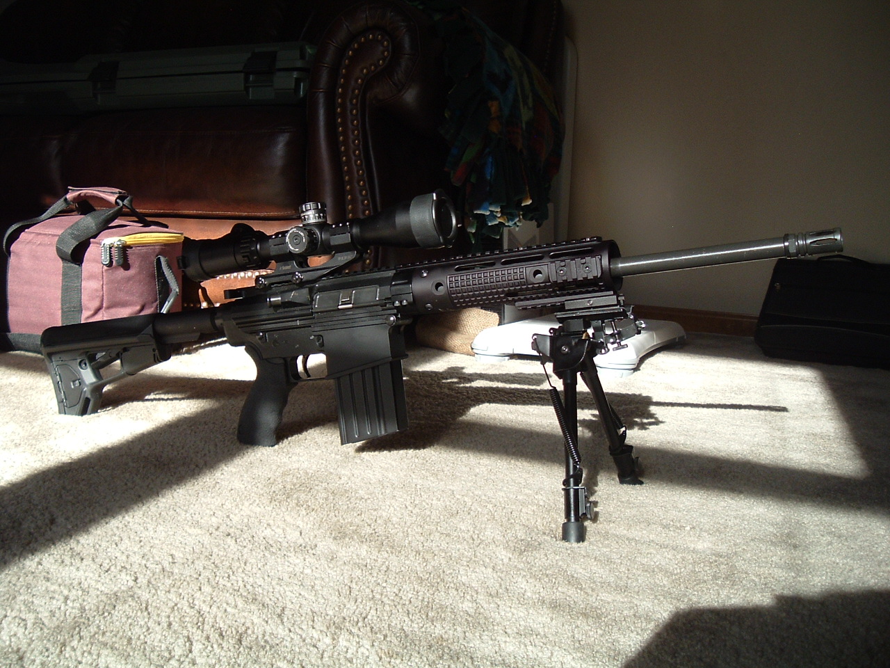

seasprite Posted January 28, 2013 Report Share Posted January 28, 2013 I used pri steel low profile adjustable gas block on my DPMS works good and I can still adjust it with the Apex free float tube on it.http://308ar.com/forum/general-discussion/picked-up-an-pri-adjustable-gas-block-today/?action=dlattach;attach=5370;image Quote Link to comment Share on other sites More sharing options...
MONTANA308 Posted January 28, 2013 Author Report Share Posted January 28, 2013 Ok thanks good to know you can still adjust with the apex hand guard. I haven't decided on a hand guard yet I just received a black rain ordance rifle length quad rail. It seems like a really nice piece of metal. Quote Link to comment Share on other sites More sharing options...
