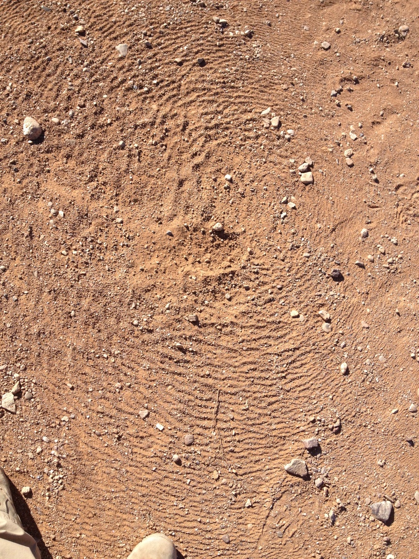

planeflyer21 Posted December 18, 2013 Report Share Posted December 18, 2013 Went out to babysit a club member, shot an XDM .45 4.5 while watching him. ZERO wind…smoke from gunpowder and burning lube just hung in the air. Very good low visibility practice. Then, after he left, ran a hundred and twenty rounds through Liberty of the PPU 175gr. Lost one primer, couldn't find it but had two FTFire afterwards. Need to take her down and find where it went…this time. Reloaded empty mags (somehow turned into seven), refilled the go-bag, and have one box of the 1,000 round of PPU left. Going to start my .308 HEAVY experiments soon! So who knows what this design in the sand is from? Quote Link to comment Share on other sites More sharing options...
sketch Posted December 18, 2013 Report Share Posted December 18, 2013 You've landed on the moon! Quote Link to comment Share on other sites More sharing options...
Matt.Cross Posted December 18, 2013 Report Share Posted December 18, 2013 So who knows what this design in the sand is from? I know you're going to try to blame it on your muzzle brake, but I know better. That's what you get when you start your day off with too many bean burritos..... <laughs> <lmao> Quote Link to comment Share on other sites More sharing options...

sketch Posted December 18, 2013 Report Share Posted December 18, 2013 (edited) So it's not a blast from a muzzle ? Edited December 18, 2013 by sketch Quote Link to comment Share on other sites More sharing options...

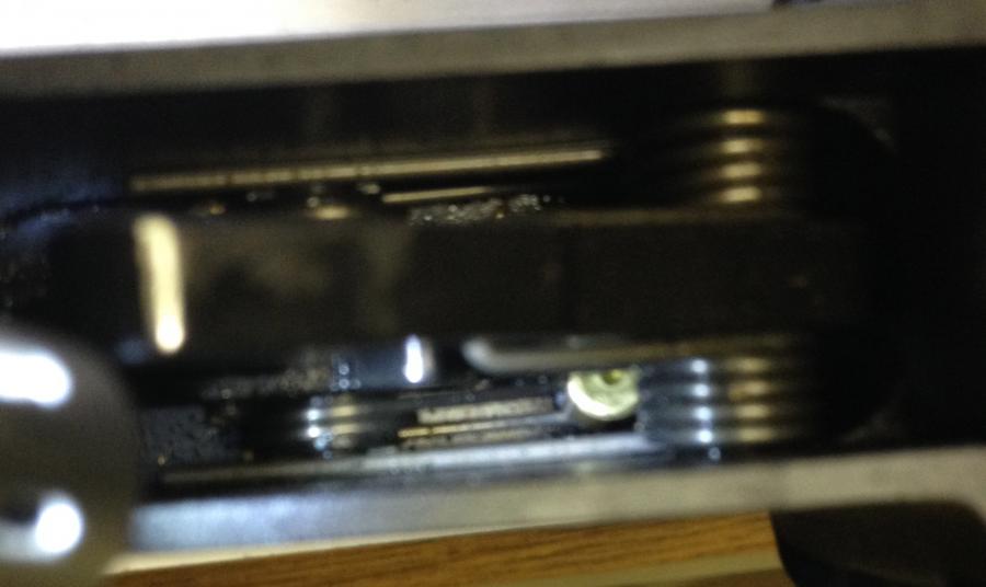

planeflyer21 Posted December 18, 2013 Author Report Share Posted December 18, 2013 Lost primers, even you don't see them in there , seem to find a way to screw things up . I had one once that feed into the chamber with a cartridge, took a bit to get it out . Would not want that to happen in a fire fight , that's for sure. Prior to yesterday, I've had one get in the trigger group and foul things up and another that got in the barrel locking lugs, which wouldn't let the bolt close. Found a place describing how to stake the primers…gonna give that a try when reloading these. you dropped trou and sat down in the sand? :) Wash That probably is what the shockwave would look like! Quote Link to comment Share on other sites More sharing options...

planeflyer21 Posted December 18, 2013 Author Report Share Posted December 18, 2013 So it's not a blast from a muzzle ? Yes…but not a brake. The stock LAR-8 Vortex flash hider. If you look at the photo closely, it appears that there are two relatively straight lines that follow the cuts in the hider. Dug out the fired primer (that popped out of the Pervy Prtizen case) from the trigger group this afternoon. There was just enough room in the lower receiver for the primer to move a bit. One way, it got under that front trigger flange, another it would keep the hammer from travelling all the way forward and firing. As you can see from the photos, I had to remove the hammer to get the primer out. Tried shaking it out to no avail. This happening in a firefight would suck beyond all suckiness. Quote Link to comment Share on other sites More sharing options...
