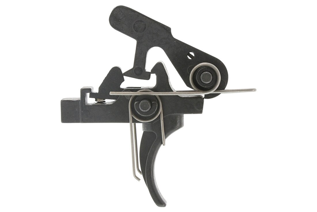

98Z5V Posted December 28, 2019 Report Share Posted December 28, 2019 (edited) 14 hours ago, Anderson3754 said: Is anyone aware of a source of hammers with Neutral sear engagement, instead of the traditional Positive engagement ? Regards You're looking for this kind of design, right here: Mil-spec trigger designs are far from this. Stay away from RRA 2-Stage in this design. Geissele, Larue, Armalite, and others offer this design. That IS the RRA I pictured above. This is the LaRue: This is a Geissele Hi-Speed NM trigger: Here's the Armalite NM trigger: Edited December 28, 2019 by 98Z5V Quote Link to comment Share on other sites More sharing options...
Anderson3754 Posted December 28, 2019 Author Report Share Posted December 28, 2019 1 hour ago, 98Z5V said: You're looking for this kind of design, right here: Mil-spec trigger designs are far from this. Stay away from RRA 2-Stage in this design. Geissele, Larue, Armalite, and others offer this design. That IS the RRA I pictured above. This is the LaRue: This is a Geissele Hi-Speed NM trigger: Here's the Armalite NM trigger: Nice thanks.... Geissele or Larue any reason to buy one over the other ? Quote Link to comment Share on other sites More sharing options...

Matt.Cross Posted December 28, 2019 Report Share Posted December 28, 2019 9 minutes ago, Anderson3754 said: Nice thanks.... Geissele or Larue any reason to buy one over the other ? Application. The LaRue is the most cost effective choice and an unbeatable value, the Geiselle NM is the ultimate in precision trigger dynamics. The best choice will be entirely dependent on your intended use. Quote Link to comment Share on other sites More sharing options...
98Z5V Posted December 28, 2019 Report Share Posted December 28, 2019 3 minutes ago, Anderson3754 said: Nice thanks.... Geissele or Larue any reason to buy one over the other ? Depends on what you're looking for, ultimately. You need to state what you're after here, first. I have several of both, for different reasons. LaRue - pure high quality, 2-stage trigger, 2.5lbs first stage, 4.5lbs (combined weight) for the second stage, non adjustable, and $90 regularly. What a great trigger, at a price that's unreal. I'd buy more at twice the price - and they used to be twice the price... Geissele - There is no higher quality - Adjustable from 1.5lbs to 5lbs first stage, to 6oz to 1.5lbs second stage. Those weights span all three configurations of the Geissele Hi-Speed trigger (National Match, DMR, and Service triggers). Full-Rip retail from Geissele is $279. Holiday sales come in cheaper, but not by much. I have several of both, and I made that decision on what I wanted that specific gun to do. Most of the time, I'll buy the LaRue, because you just CANNOT beat that trigger's performance for the dollars that you shell out. There are other times that I just want a little bit more, though - and I'll shell out that extra $200 to have that Geissele trigger in that specific gun, for that specific purpose... What you want in the trigger determines which one you'll buy. That's on you, and what you really want... Quote Link to comment Share on other sites More sharing options...
