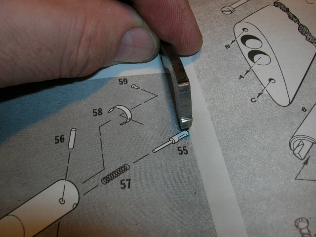

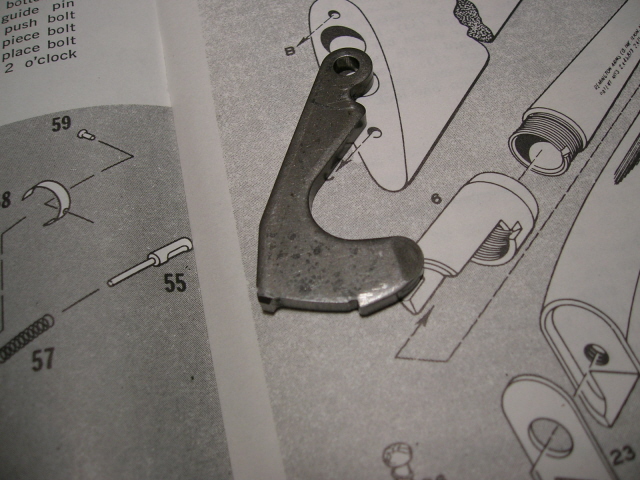

survivalshop Posted January 23, 2013 Author Report Share Posted January 23, 2013 Finally got around to disassembling the 870 & ordered a" Accuracy Speaks "hammer set up for it & will order the Timney 870 fix later .The hammer sear is just gone , not sure if you can see it in the photo's , but it sheared right off. Quote Link to comment Share on other sites More sharing options...
planeflyer21 Posted January 24, 2013 Report Share Posted January 24, 2013 Yup.That'll do it.Might have been real fun on an 1100.Jon Quote Link to comment Share on other sites More sharing options...
