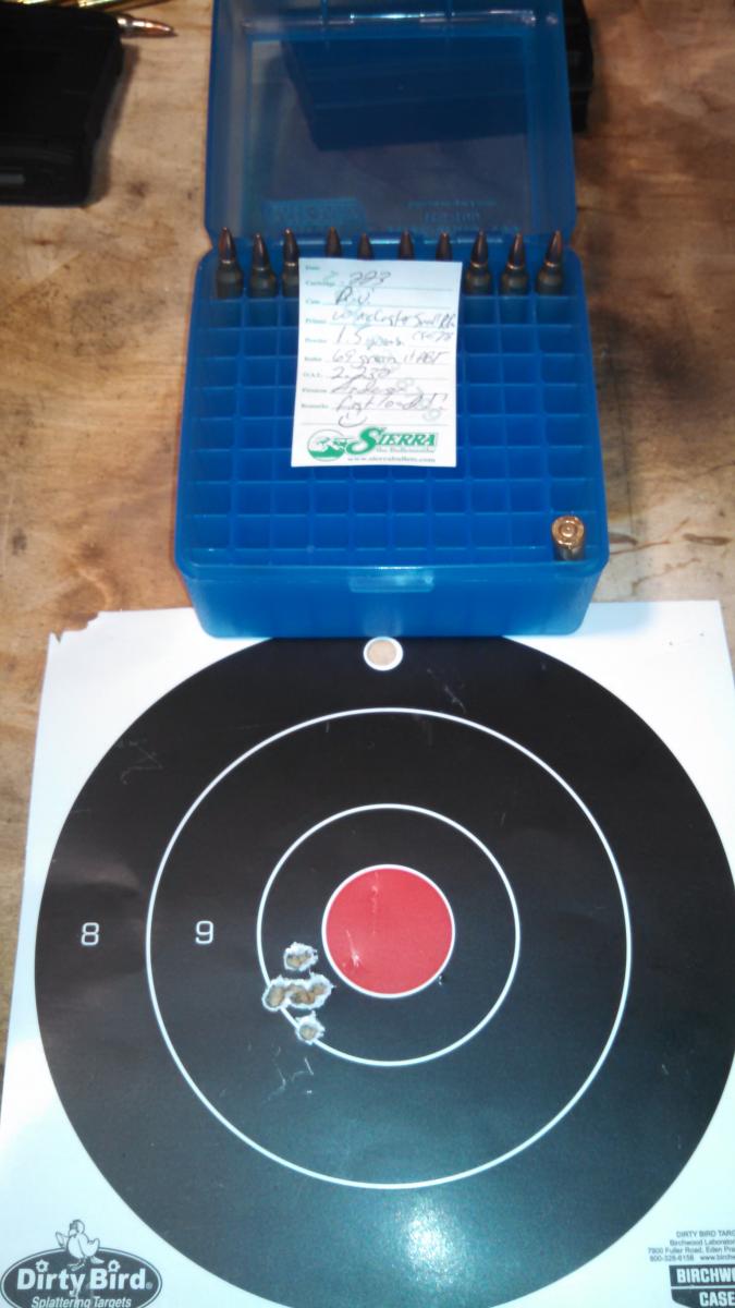

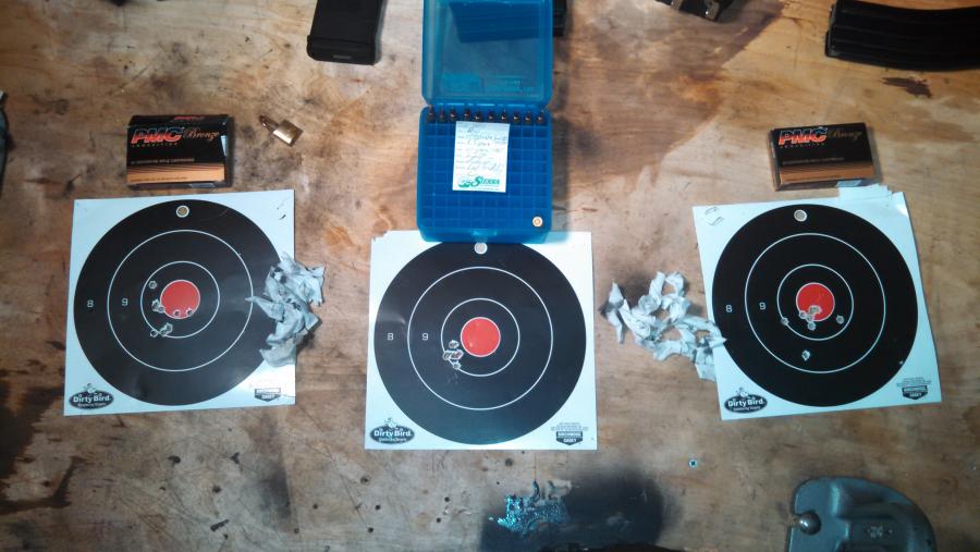

j.peace Posted October 12, 2014 Author Report Share Posted October 12, 2014 So here's the update on reloading. I picked up a used rock chucker for 50 bucks . a used tumbler for 10 bucks. Used rcbs uniflow powder measure for 50 bucks. The. Lee case trimmer. and I already have a good digital scale and calipers . I decided to reload .223 before I try .308 . so I loaded 20 trial rounds and only shot 10. They told me what I needed to know. I shot three strings of 10 rounds. With cleaning and cooldown before each string of 10 . PMC first then my reloads then PMC. Quote Link to comment Share on other sites More sharing options...
j.peace Posted October 12, 2014 Author Report Share Posted October 12, 2014 Here's some better pics of targets Quote Link to comment Share on other sites More sharing options...
unforgiven Posted October 12, 2014 Report Share Posted October 12, 2014 Nice shooting brother J. Quote Link to comment Share on other sites More sharing options...
