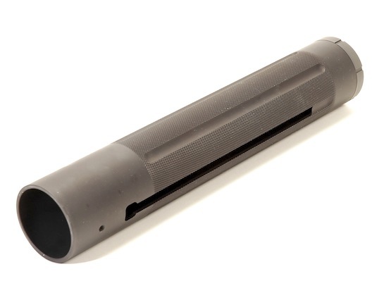

COBrien Posted June 3, 2016 Author Report Share Posted June 3, 2016 Just pulled the trigger on a FA tube on the popular online auction site. FA says they don't know when they'll be getting a new batch of the non-slotted tubes. They've been due from the supplier since December, and they're always "just a couple weeks out." Found this one online used (mounted once, guy changed his mind and removed it), with a barrel nut wrench for $100 with free shipping. Couldn't have gotten it cheaper from FA directly, that's for sure. Now to find myself a low-pro gas block. I trust FA's is good, I just don't know that I want to pay $10 shipping on a $30 part... Quote Link to comment Share on other sites More sharing options...

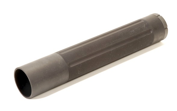

COBrien Posted August 30, 2016 Author Report Share Posted August 30, 2016 Just to bring this thread full circle... Fulton Armory Rifle-Length Handguard, FA low profile .750" I.D. gas block (obviously not visible...), and SEI "Good Iron" brake. Quote Link to comment Share on other sites More sharing options...
