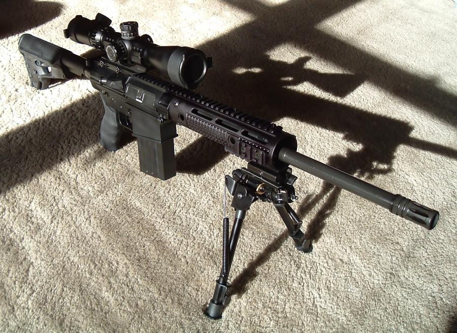

98Z5V Posted August 24, 2013 Report Share Posted August 24, 2013 (edited) 18" barrel and the Troy 13.8" rail look fine together. Trust me, it's not too much rail. MRF-308 rail (13.8") and a Fulton 18.5" barrel. Works great... Edited August 24, 2013 by 98Z5V Quote Link to comment Share on other sites More sharing options...
Matt.Cross Posted August 24, 2013 Report Share Posted August 24, 2013 18" barrel and the Troy 13.8" rail look fine together. Trust me, it's not too much rail. MRF-308 rail (13.8") and a Fulton 18.5" barrel. Works great... That adjustable buttpad makes my pants shrink every time... :drool: Quote Link to comment Share on other sites More sharing options...
will92104 Posted August 24, 2013 Author Report Share Posted August 24, 2013 18" barrel and the Troy 13.8" rail look fine together. Trust me, it's not too much rail. MRF-308 rail (13.8") and a Fulton 18.5" barrel. Works great... Now that i see it with an 18 inch barrel, it doesn't look to bad. it's only about 3 in more that the rainier arms. plus it would save me some $$$ but i would have to buy a barrel nut. I'm teetering, which way i fall is anybodies guess. Quote Link to comment Share on other sites More sharing options...
98Z5V Posted August 24, 2013 Report Share Posted August 24, 2013 Troy's 13.8" rails (MRF or TRX) just cover a micro gas block on a rifle-length gas system, man. Perfect. Quote Link to comment Share on other sites More sharing options...
