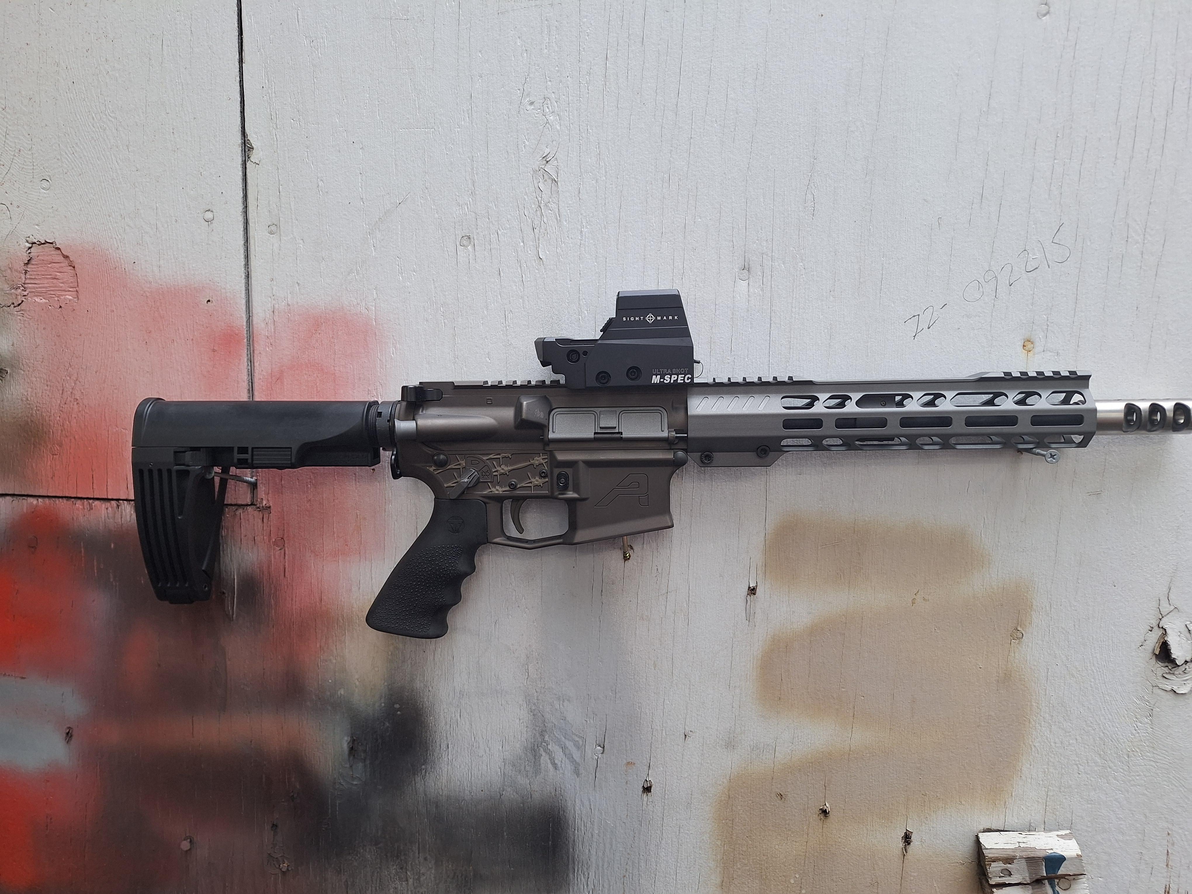

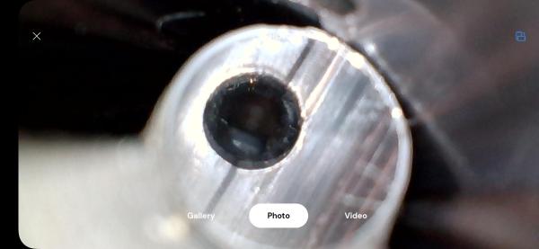

Albroswift Posted August 1 Report Share Posted August 1 (edited) Been following this thread, 300BO Pistol configuration 10.5" B/A Barrel 1:7 Pistol gas 5-1/2" +/- dwell Port was 0.095, stepped it up to 0.101 Yellow Sprinco 20% reduced spring Shooting for Subsonic 220gr Off the bench cycles and locks back Lil Gun and H110 220gr handloads and Grizzly factory 220 gr subs Off hand tight to shoulder cycles but iffy on lock back Hold at arms length cycles 2 out of 3. Looking into the port with the bore camera the gas block port is smaller then the barrel port. Seekins low profile AGB. Next step open up the gas port some more. Is opening up the AGB port a thing? How far should I go? With powders like Lil Gun and H110, enough gas pressure for subsonics? Only have 100 rounds through it, maybe more break in? Edited August 1 by Albroswift Quote Link to comment Share on other sites More sharing options...
Albroswift Posted August 8 Report Share Posted August 8 OK, squared away. Opened up the barrel port to 0.110", opened up the gas block to 0.110" Cycles and locks back on everything. 300BO Pistol configuration 9.9gr H110 powder 220gr subsonics 10.5" B/A Barrel 1:7 Pistol gas 5-1/2" +/- dwell Port was 0.095, stepped it up to 0.101 (Stepped it up again to 0.110") Yellow Sprinco 20% reduced spring Quote Link to comment Share on other sites More sharing options...
