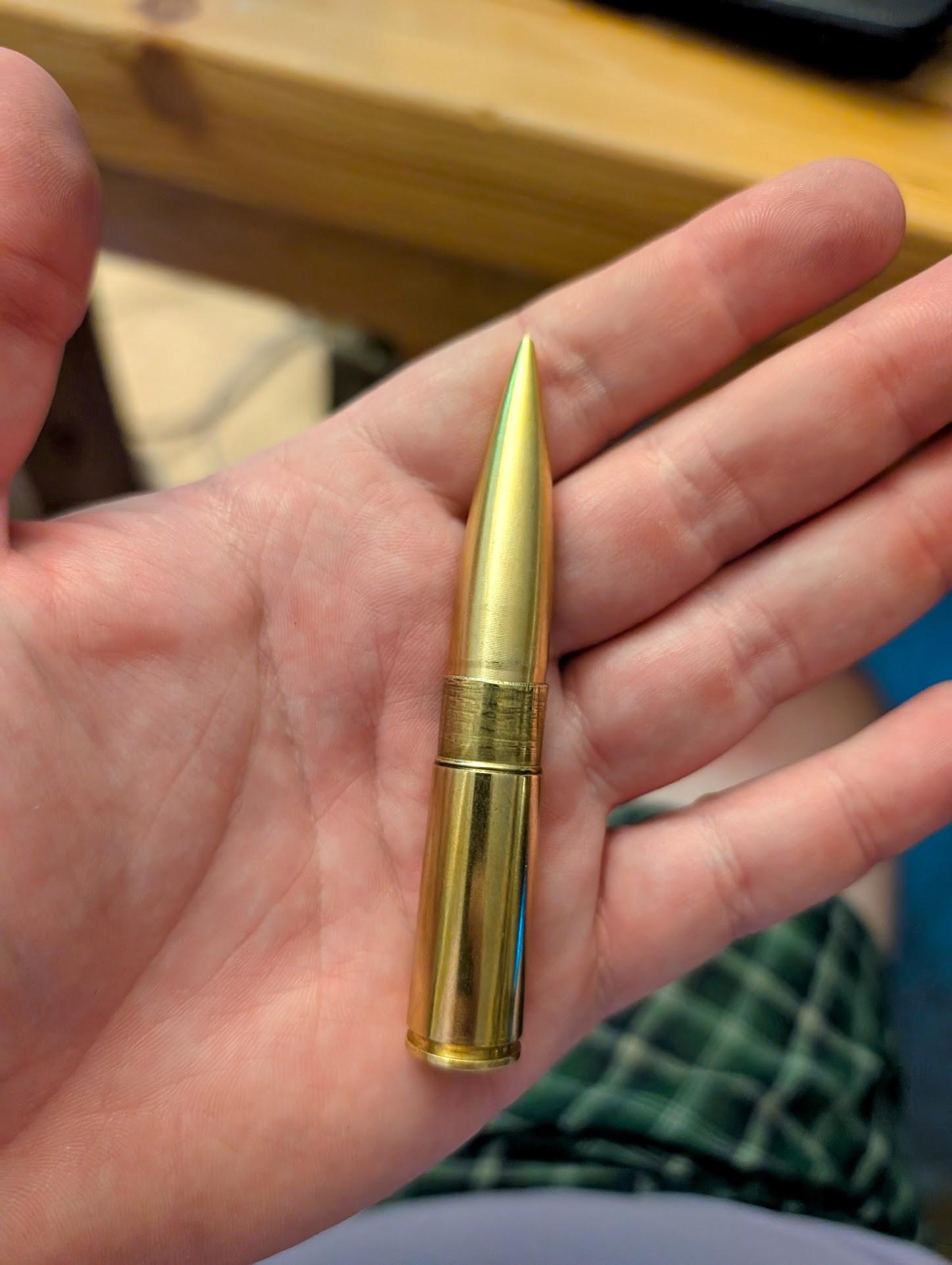

I’ve done 260, 308, 375 Raptor and 280 British so far.  280 Brit was a long project getting custom reamer and gauges, custom forming sizing and seating dies and custom pipe.  Runs real well though and surprisingly accurate once the load was worked out.

You made me look up 280 Brit...
Yeah pretty interesting cartridge with an interesting back story.  I thought it would be a fun “what if” project as in what if the 280 Brit had ended up as the NATO standard instead of 308.  Took me almost two years to build but it turned out to be really nice to shoot and a one of a kind piece.
