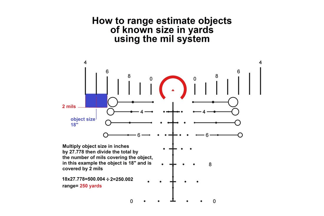

98Z5V Posted June 8, 2020 Report Share Posted June 8, 2020 (edited) I'm with you on the MOA BS. @Matt.Cross is gonna get on me about that, but I'm all in for mils. However... BDC is the fastest. You're shooting .308 Win. Right away, I'd recommend the PA 4-14 BDC scope: https://www.primaryarms.com/primary-arms-4-14x44mm-riflescope-acss-hud-dmr-308-223-reticle here's the reticle: Now, for mils, I wouldn't recommend the PA mil-dot scope. For SURE, I'd recommend you the Athlon Talos BTR 4-14 scope with the APLR2 reticle. I have a PILE of these things. They're great scopes, for the money, and don't break the bank. https://athlonoptics.com/product/rifle-scopes-talos-btr-4-14x44-aplr-ffp-ir-mil/ here's the reticle: Edited June 8, 2020 by 98Z5V Quote Link to comment Share on other sites More sharing options...
98Z5V Posted June 8, 2020 Report Share Posted June 8, 2020 (edited) The benefit of the Athlon over that PA I recommended - on the Athlon, the WHOLE GRID is iluminated. On that PA, only the center dot is illuminated. That can make a big difference, if you shoot in any low-light/no-light conditions. That's where the Athlon kicks ass, with the entire grid illuminated. If you never shoot at night - both are great. That PA BDC scope is fast as hell on targets at different ranges. 500~600 yards with either one of these scopes is a no-brainer. Edited June 8, 2020 by 98Z5V Quote Link to comment Share on other sites More sharing options...
