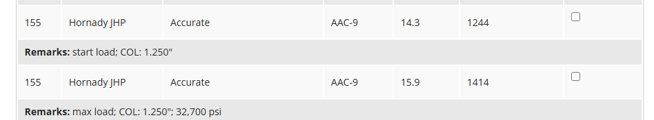

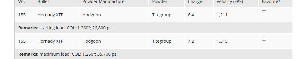

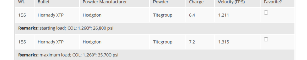

Albroswift Posted July 8, 2025 Author Report Share Posted July 8, 2025 (edited) Don't sweat missing this, kind of a back burner project. I get it out every once in a while, run some loads, don't fuk with it for months, run some new ammo or spring, repeat. Yes. Blowback. Getting around 1730 fps w/ 15.6gr AA#9 1640fps w/ 6.8gr Titegroup. I'd scrap it but it's a blast to shoot and accurate, and not very loud. Not much more then the 40. I get around the 1430's with the 40. Reload ladders, started out #9 laddered from 14.8 to 15.6. Too compressed at anything over 15.6 Titegroup did the whole 6.4 to 7.2 Getting way over the published velocity as expected, Using 155 XTP's. The thing is, though, Hot loads or weak loads don't make much of a difference as far as case separation. Case goes fully into chamber with extractor under rim so not unsupported blowout. Separation point about mid case. Found a source for 8-1/2" Extensions so adding another 3/4" + 1 more tungsten weight to the buffer. 14.6 oz buffer 3.6 oz additional weight 14.6 oz BCG Almost 33 oz reciprocating mass for the next trip to the range. Swapping BCG's with the 40. Think I'm going to back off on the spring go back to an orange or red. If this doesn't work, I have a 12" barrel to try. Also tried some PMC 180's, same. Edited July 8, 2025 by Albroswift Quote Link to comment Share on other sites More sharing options...

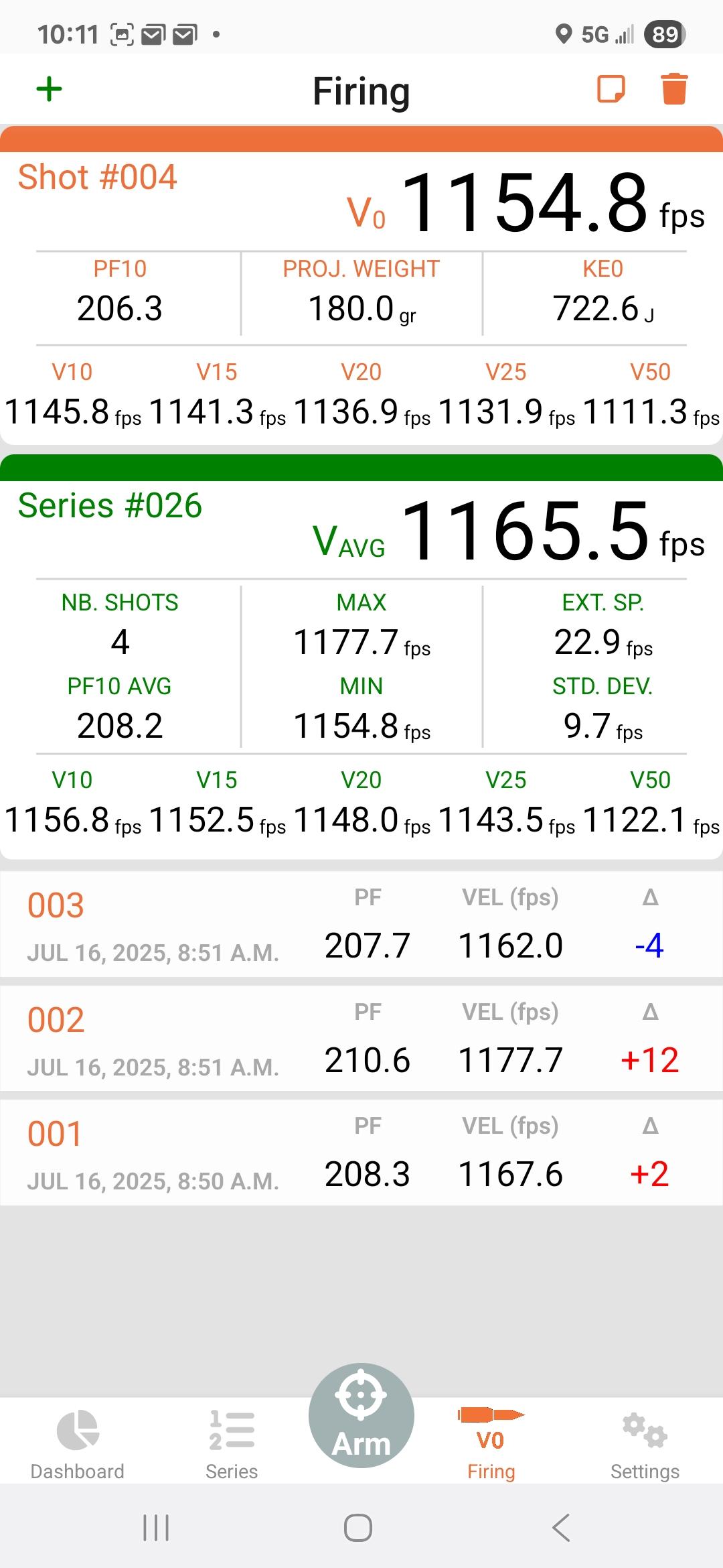

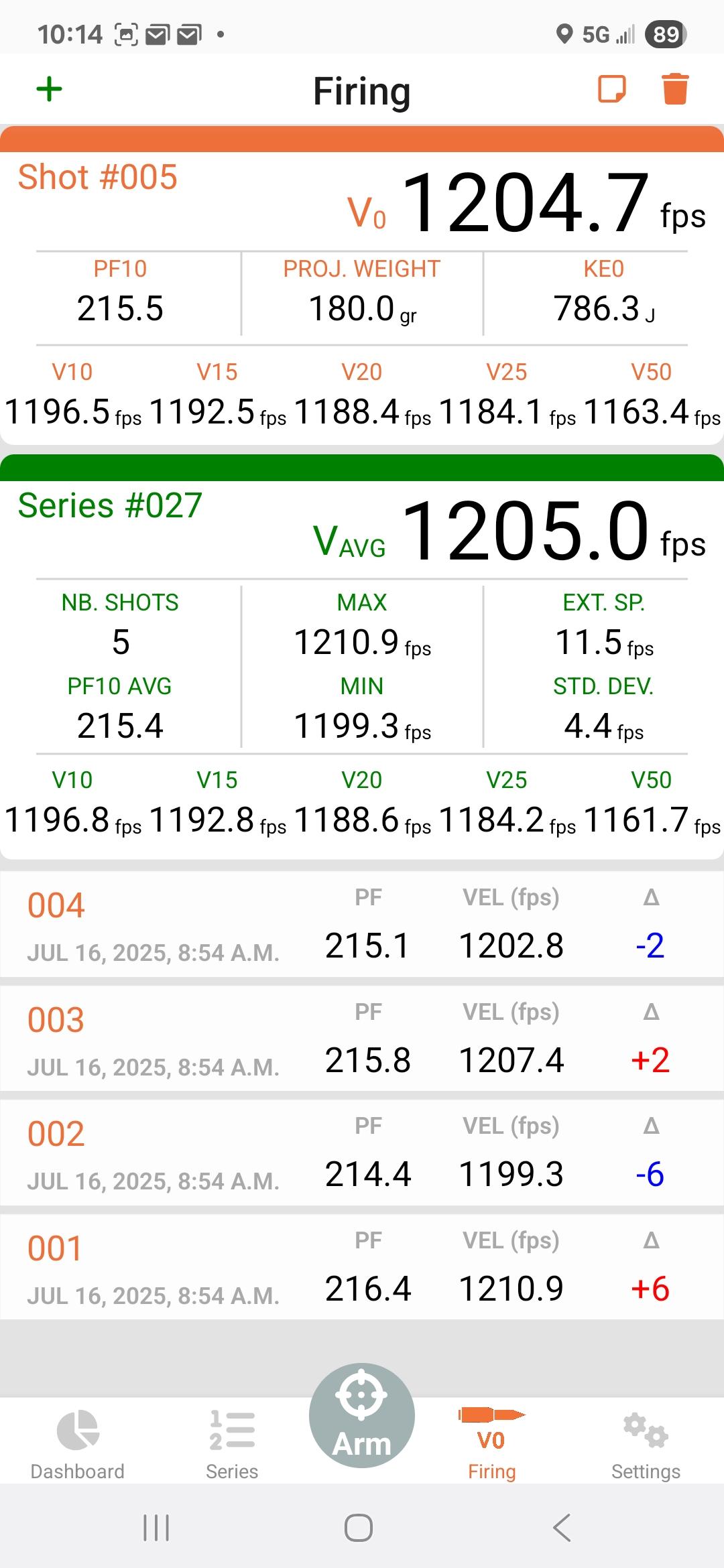

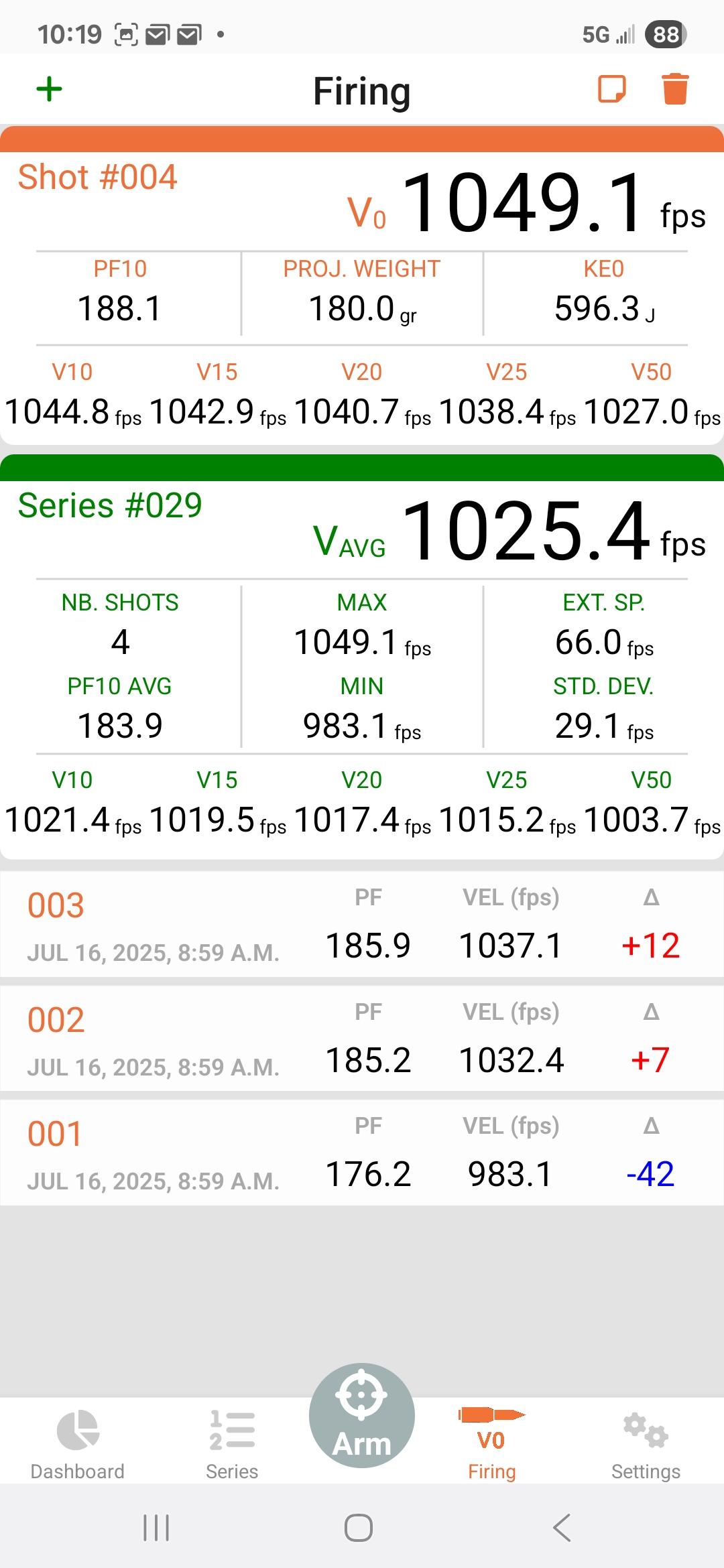

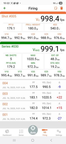

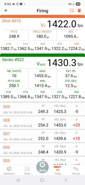

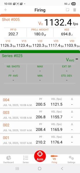

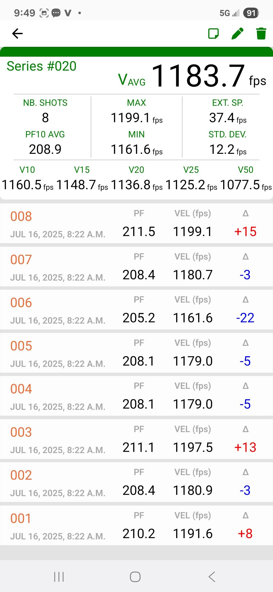

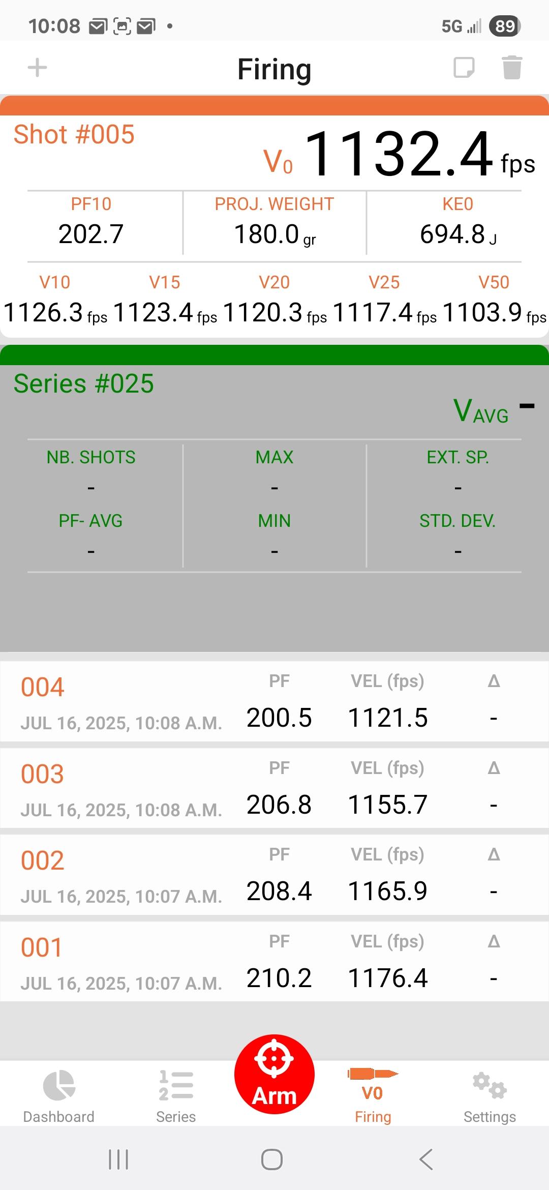

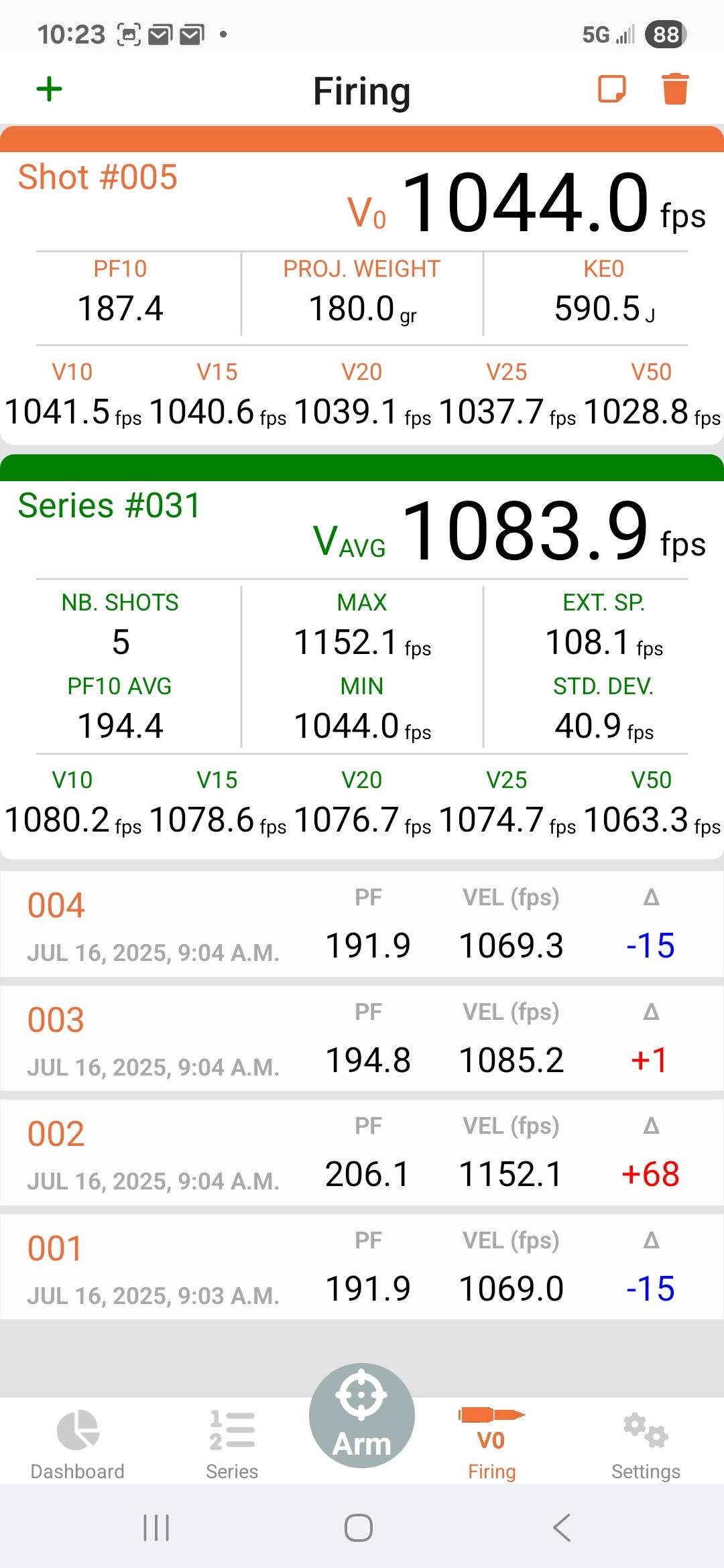

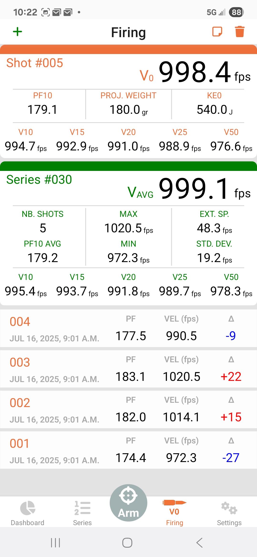

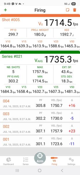

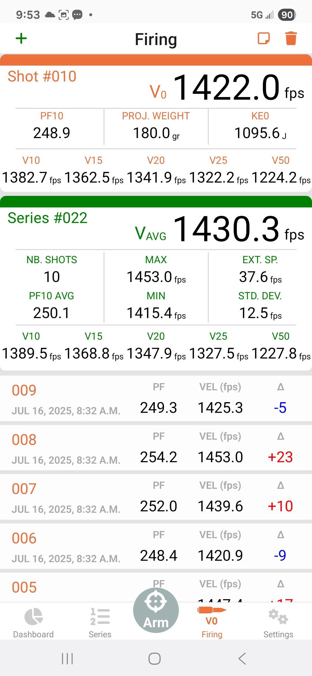

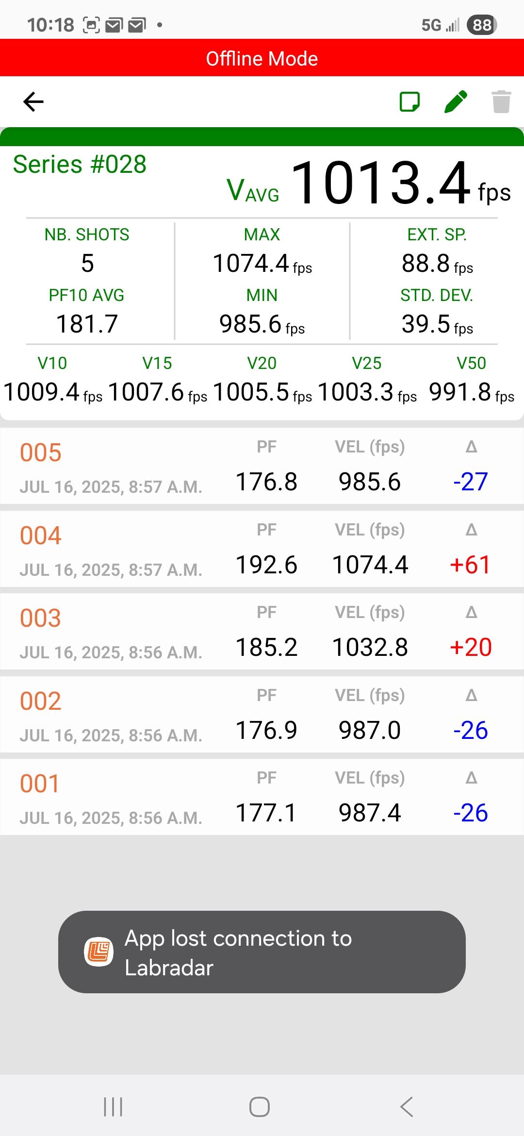

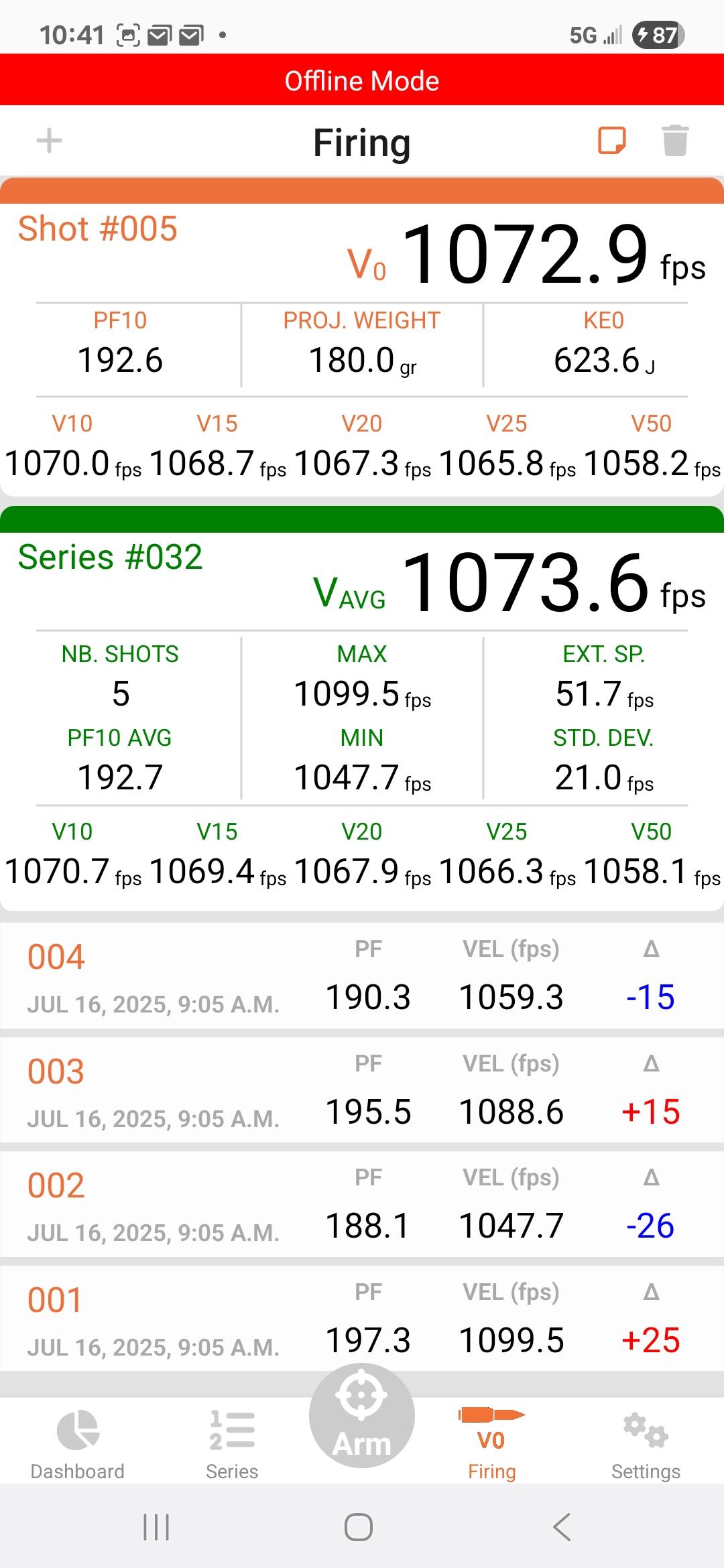

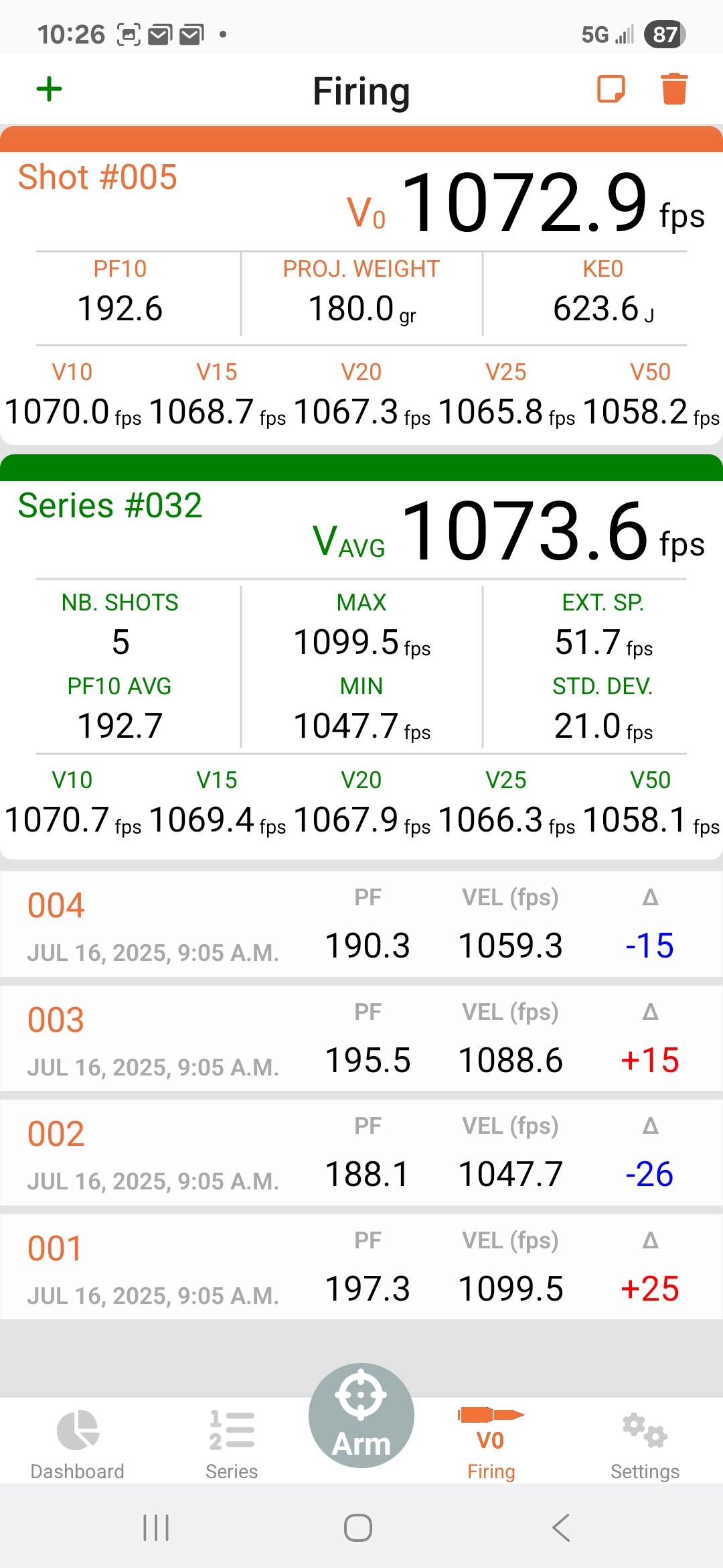

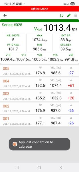

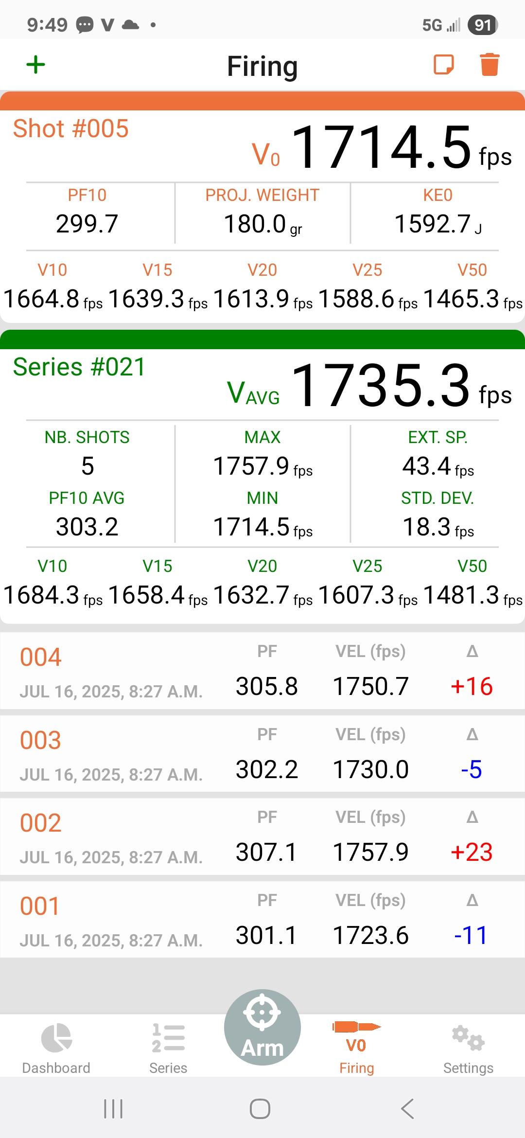

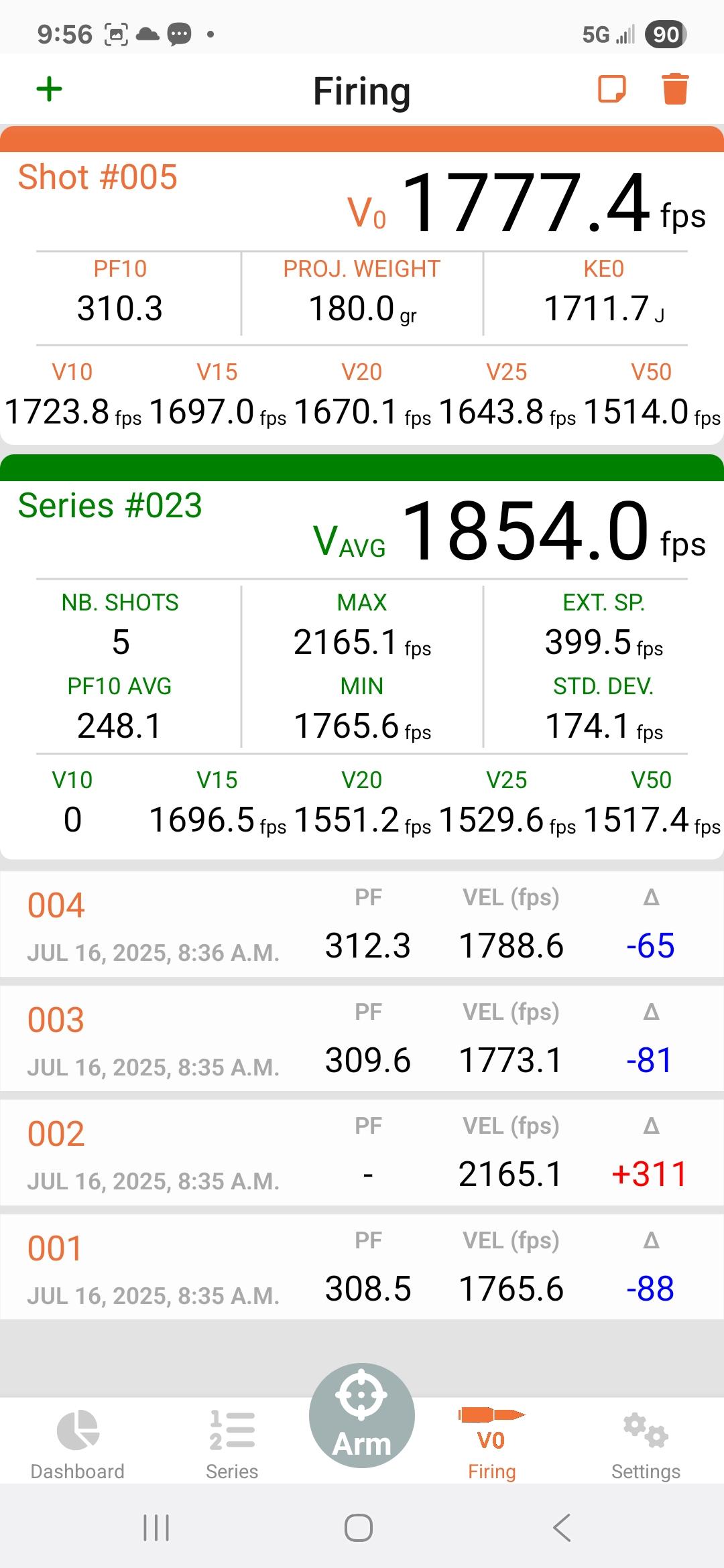

Albroswift Posted July 16, 2025 Author Report Share Posted July 16, 2025 (edited) Woo Hoo! 10mm MFer moves from the "Needs Work" category to the MFing Blaster category. Did a couple things, first checked the headspace/ removed barrel, dropped in a round, snapped the BCG over the rim. Ran test adding shims until extractor didn't go under rim, about 0.007". Don't know what it is supposed to be but that seemed good. Full forward BCG contacts barrel face with round in chamber. Go/ No go gauges for the 1911's about the same results. So pushed the finishing reamer in all the way and spun it without pushing very hard, cut the rifling back a bit without pushing the shoulder back much. Used a white wool bit with some jeweler's rouge on the Dremel to really polish the chamber out. Put an 8-1/2" carbine extension on and added another 3.5 oz to the recoil mass. Went with the orange spring. First ran some factory 180 gr. Not too impressive but worked 100% Good SD's. 155gr XTP over 15gr AAC#9 This is what I'm talking about! 15.7 gr AAC#9, compressed load. I think the 2165fps is a mis read by the labradar. 6.8 gr Titegroup 155gr XTP Chewed through everything I threw at it, brass looked great. I'll clean it up and look closer later. Then ran some 300 BO tests. EDIT screwed up the order. Fixed now. Blue 220's, Sierra 220's, and some super-cheapo 220's. 220gr Blue bullets 9.9gr H110 COL 2.130 Lost communication. Edit: I have the order fixed I think. 220gr Blue 2.130 COL 9gr AAC#9 Didn't cycle reliably. 9.0 Lil Gun 2.130 COL 220gr Blues. Budget 220 gr FMJ's 9.9 H110 COL 2.100 #9 failed to cycle at 9.0 gr Lil Gun 9.0 COL 2.100 220 gr budget pill Sierra SMK 220's COL 2.220 #9 at 9 gr failed to cycle. 9.9gr H110 I think the 1152 is a mis read or a bad load. SMK 220 9.0 Lil Gun Like this one. Nice day at the range, got a lot of data. Out of 12 or so loadings, didn't have to dig one shell out. The AAC#9 in the 300 didn't have enough gas to pick up a round but did clear the port with the empties so pretty close. The 10mm ran flawlessly from put puts to full blow loads. Locked back on everything. I see a suppressor in my future. Edited July 17, 2025 by Albroswift Quote Link to comment Share on other sites More sharing options...
Jeff300 Posted July 28, 2025 Report Share Posted July 28, 2025 On 7/16/2025 at 1:12 PM, Albroswift said: Woo Hoo! 10mm MFer moves from the "Needs Work" category to the MFing Blaster category. Did a couple things, first checked the headspace/ removed barrel, dropped in a round, snapped the BCG over the rim. Ran test adding shims until extractor didn't go under rim, about 0.007". Don't know what it is supposed to be but that seemed good. Full forward BCG contacts barrel face with round in chamber. Go/ No go gauges for the 1911's about the same results. So pushed the finishing reamer in all the way and spun it without pushing very hard, cut the rifling back a bit without pushing the shoulder back much. Used a white wool bit with some jeweler's rouge on the Dremel to really polish the chamber out. Put an 8-1/2" carbine extension on and added another 3.5 oz to the recoil mass. Went with the orange spring. First ran some factory 180 gr. Not too impressive but worked 100% Good SD's. 155gr XTP over 15gr AAC#9 This is what I'm talking about! 15.7 gr AAC#9, compressed load. I think the 2165fps is a mis read by the labradar. 6.8 gr Titegroup 155gr XTP Chewed through everything I threw at it, brass looked great. I'll clean it up and look closer later. Then ran some 300 BO tests. EDIT screwed up the order. Fixed now. Blue 220's, Sierra 220's, and some super-cheapo 220's. 220gr Blue bullets 9.9gr H110 COL 2.130 Lost communication. Edit: I have the order fixed I think. 220gr Blue 2.130 COL 9gr AAC#9 Didn't cycle reliably. 9.0 Lil Gun 2.130 COL 220gr Blues. Budget 220 gr FMJ's 9.9 H110 COL 2.100 #9 failed to cycle at 9.0 gr Lil Gun 9.0 COL 2.100 220 gr budget pill Sierra SMK 220's COL 2.220 #9 at 9 gr failed to cycle. 9.9gr H110 I think the 1152 is a mis read or a bad load. SMK 220 9.0 Lil Gun Like this one. Nice day at the range, got a lot of data. Out of 12 or so loadings, didn't have to dig one shell out. The AAC#9 in the 300 didn't have enough gas to pick up a round but did clear the port with the empties so pretty close. The 10mm ran flawlessly from put puts to full blow loads. Locked back on everything. I see a suppressor in my future. Good info Al. Quote Link to comment Share on other sites More sharing options...
Albroswift Posted August 23, 2025 Author Report Share Posted August 23, 2025 Had the 10mm blaster out to the range a few times over the last month, has been 100% reliably chewing through everything from light tightgroup loads to full blow AA#9 loads and brass is coming out in reloadable condition. Shoots the loads I use in my 1911s, the ladder loads I worked up for the carbine, factory 180 Federals, and a good bullet puller for anything that says 10mm laying around on the bench and floor. Adding the weighted spacer in front of the heavy buffer seems to function fine, no issues. Might have even improved the deadblow effect, feels really good when cycling. Scoring the JRC 8-1/2" internal depth carbine extension was the final piece of the puzzle. Guy on a muzzleloader forum pointed me to that, believe it or not. Quote Link to comment Share on other sites More sharing options...
