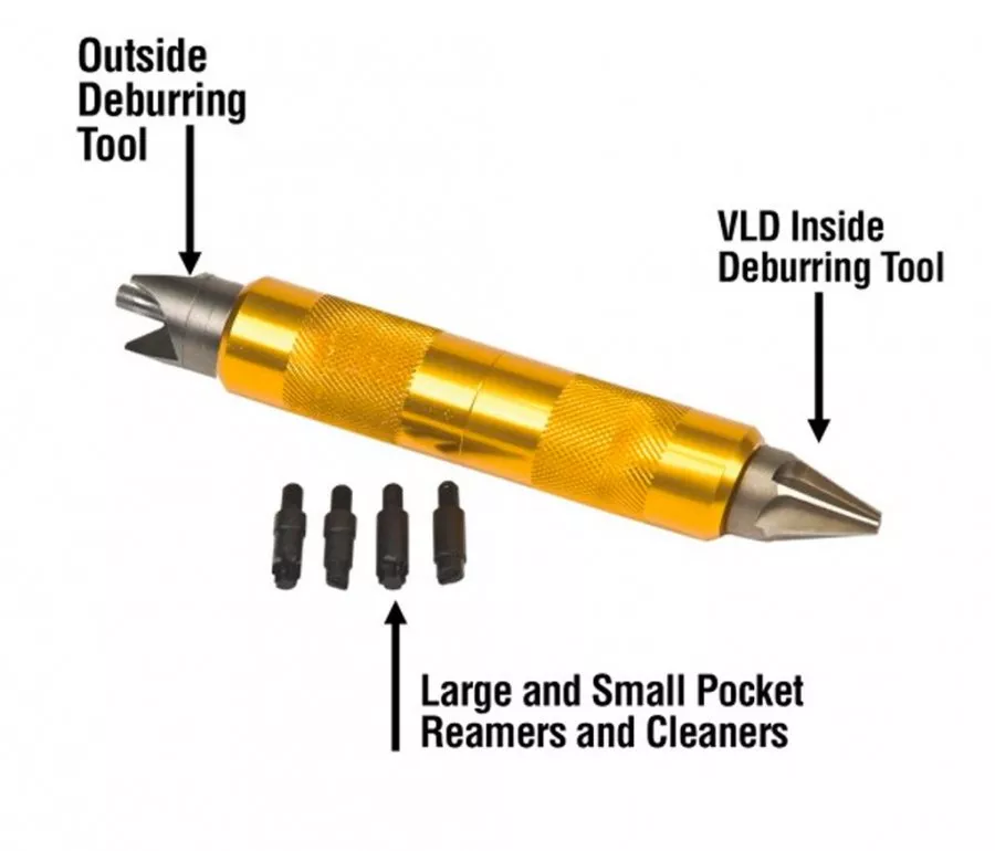

Cliff R Posted April 10, 2021 Author Report Posted April 10, 2021 Some of the Military brass I've ran into over the years isn't worth the effort to reload it. I had saved up quite a bit of 308 brass from our days on the range with the M-60. Can't even remember who made it at the moment, but when I built my first 308-AR I decided to reload some of it. The primer pockets were crimped so hard in that chit that even taking a pocket knife and chamfering the entrance AFTER cleaning/reaming it some with my deburring tool you couldn't get a primer to go into that junk with a flat punch and a BFH. I'd "munch" about 4 out of 10 primers trying to get them set to depth. The brass was also tougher than nails and thick making it difficult to size and trim to length. I suppose the "loose" specs of the M-60's chamber didn't help that scenario but I gave up messing with it and round filed it. In contrast the Lake City Match brass I had saved from my days shooting High Power Matches was superb! No issues anyplace and I even ran some thru a 7mm-08 die and necked it on down to .243 for my Varmint rifle. Those were some of the most accurate loads I ever put thru that rifle loaded with the Match brass and H414. I will admit that I haven't been saving the .223 and 5.56 brass until recently as it's been cheaper to buy than to reload.....but changing the game there and starting to fill some ammo boxes with it just in case..........
98Z5V Posted April 11, 2021 Report Posted April 11, 2021 15 hours ago, Cliff R said: Some of the Military brass I've ran into over the years isn't worth the effort to reload it. I had saved up quite a bit of 308 brass from our days on the range with the M-60. Can't even remember who made it at the moment, but when I built my first 308-AR I decided to reload some of it. The primer pockets were crimped so hard in that chit that even taking a pocket knife and chamfering the entrance AFTER cleaning/reaming it some with my deburring tool you couldn't get a primer to go into that junk with a flat punch and a BFH. for those things, Cliff, I use a Lyman VLD inner chamfer tool - that's supposed to be for case NECKS... I hit those nasty-crimped primer pockets with that thing for a good 3 or 4 twists - and that crimp, and all evidence of it, are long gone. Primers go in after that. This is the tool: https://www.lymanproducts.com/case-prep-multi-tool
dpete Posted April 11, 2021 Report Posted April 11, 2021 (edited) 13 hours ago, 98Z5V said: for those things, Cliff, I use a Lyman VLD inner chamfer tool - that's supposed to be for case NECKS... I hit those nasty-crimped primer pockets with that thing for a good 3 or 4 twists - and that crimp, and all evidence of it, are long gone. Primers go in after that. This is the tool: https://www.lymanproducts.com/case-prep-multi-tool Or you can go the power tool route and modify 98's idea. Take the pictured large and small pocket reamers and cleaners and screw them into the correctly sized aluminum coupler from any hardware store. To get this^ If you have a benchtop drill press you can then chuck those into the press, lay the press on its side, run it at its slowest speed and commence to power reaming those primer crimps out and cleaning pockets. It also works with the drill press standing up but then you are pushing the brass upward instead of from right to left. Wear a rubber coated glove on the hand you hold the brass with for a solid grip. You can ream pockets as fast as you can feed brass from one hand to the other. Your wrist will thank you after not having to twist 3 or 4 times each for hundreds of pieces of brass. Just sayin' Edited April 11, 2021 by dpete

Steve crawford Posted April 11, 2021 Report Posted April 11, 2021 (edited) I have a Lyman case prep station. It will remove the crimp clean the pocket and uniform them in just a few seconds. All you have to do is hold on to the case. I also have the RCBS Bench primer pocket swager. All you have to do with that thing is have a STRONG arm and wear a glove to make primers slide into a pocket like a hot knife through butter. The glove is to help to not have a blister in your palm after about 100 military 5.56 cases. I like to use the swager because it doesn't remove any metal. 😊😊😊 Steve Edited April 11, 2021 by Steve crawford
dpete Posted April 11, 2021 Report Posted April 11, 2021 12 minutes ago, Steve crawford said: I have a Lyman case prep station. I have the same Lyman case prep. Its slow compared to the drill press. I primarily use it for chamfering now.

Cliff R Posted April 12, 2021 Author Report Posted April 12, 2021 I've worked with Military crimped brass for decades. That particular batch of 308 brass I tried to reload was crimped so hard you had to chamfer the case entrance 1/3rd of it's depth plus ream the pockets out. I moved my primer pocket tool from the trimmer to my Dewalt drill to speed things up. In the end I was still munching some primers trying to get them seated so gave up on it. I ended up buying some new Winchester brass someplace and moved forward. At that time I was working up a load with Varget and Barnes 175 grain hunting bullets so just better all the way around to forget about trying to use Military cases in the first place. On a good note I was at Cabellas yesterday and snagged an Anderson AR-15 lower. Haven't seen one anyplace in at least 6 months. Maybe things are opening up a bit there as well?......
