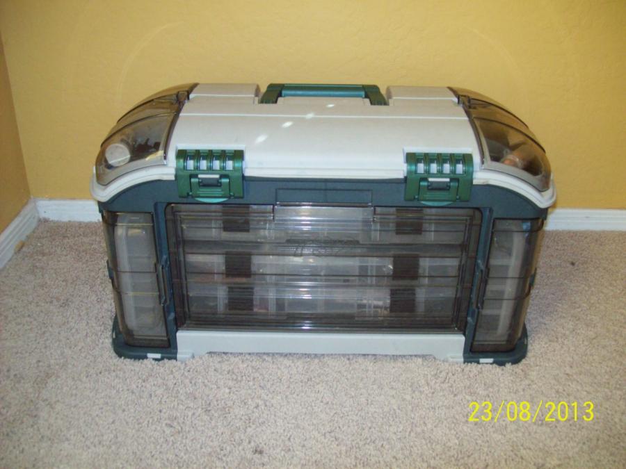

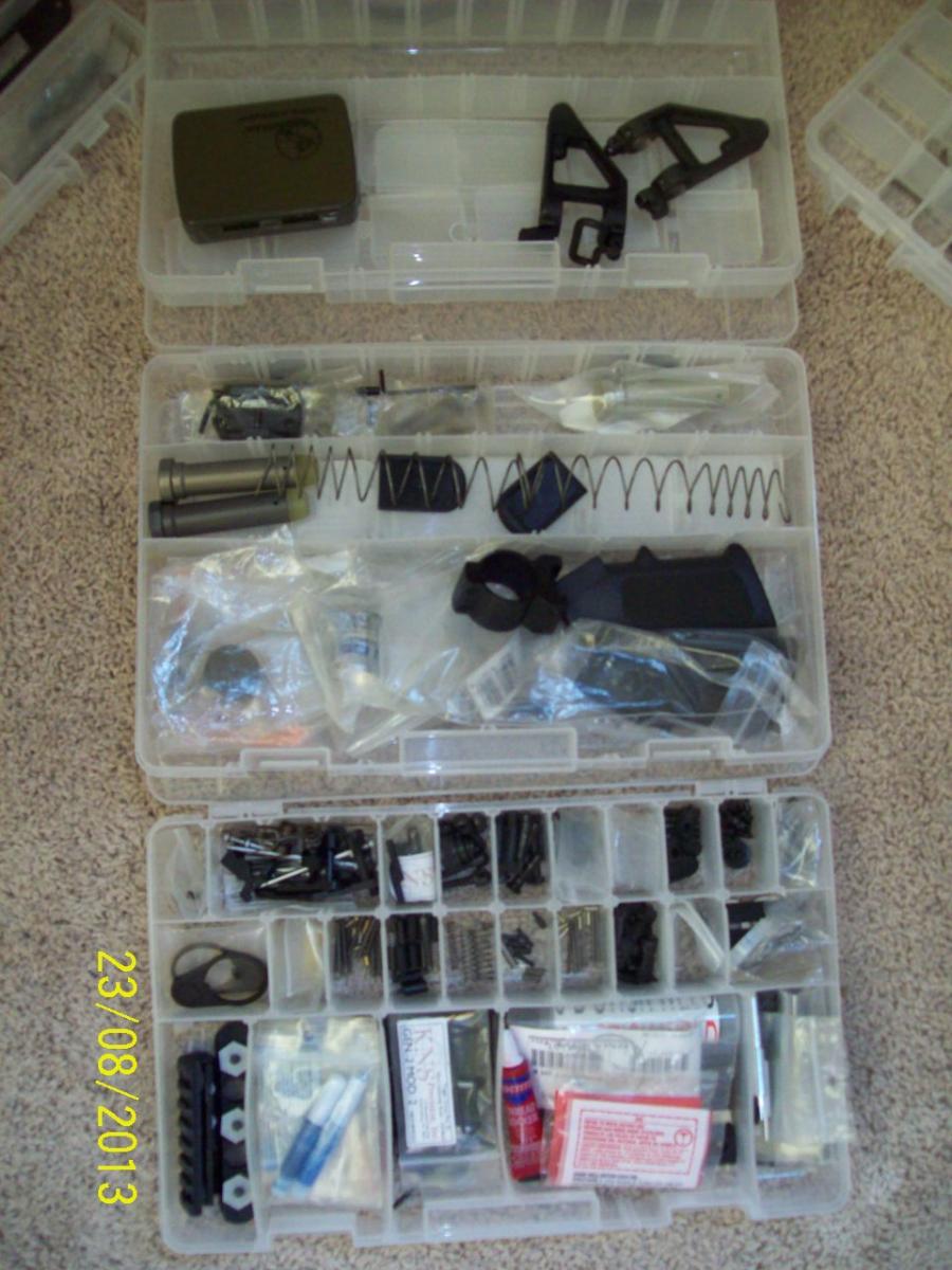

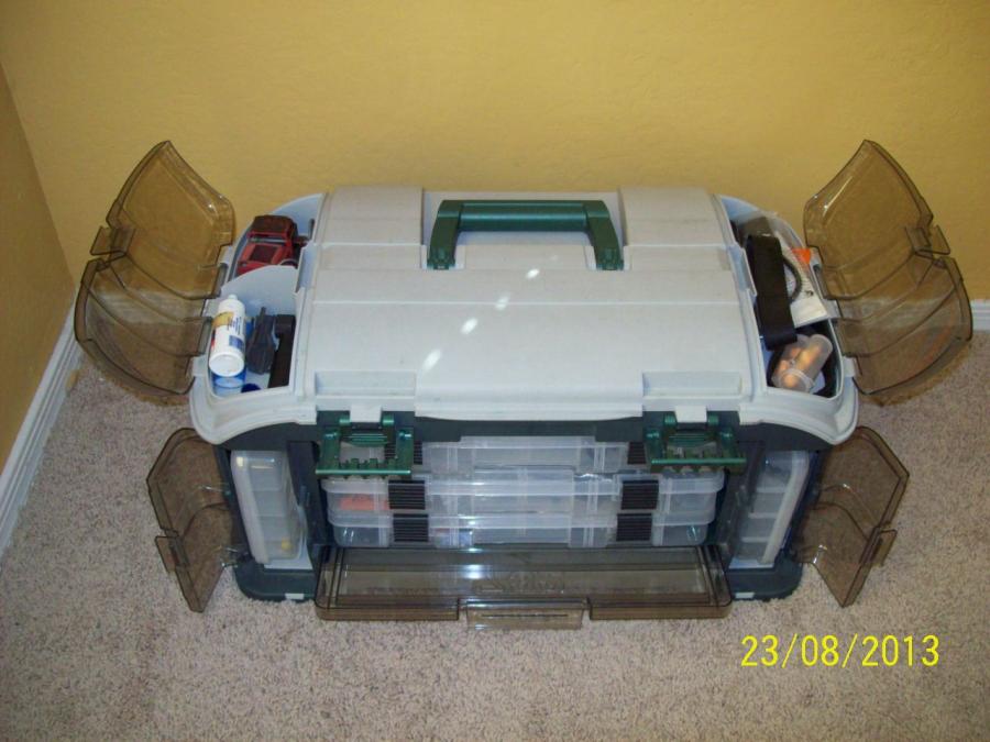

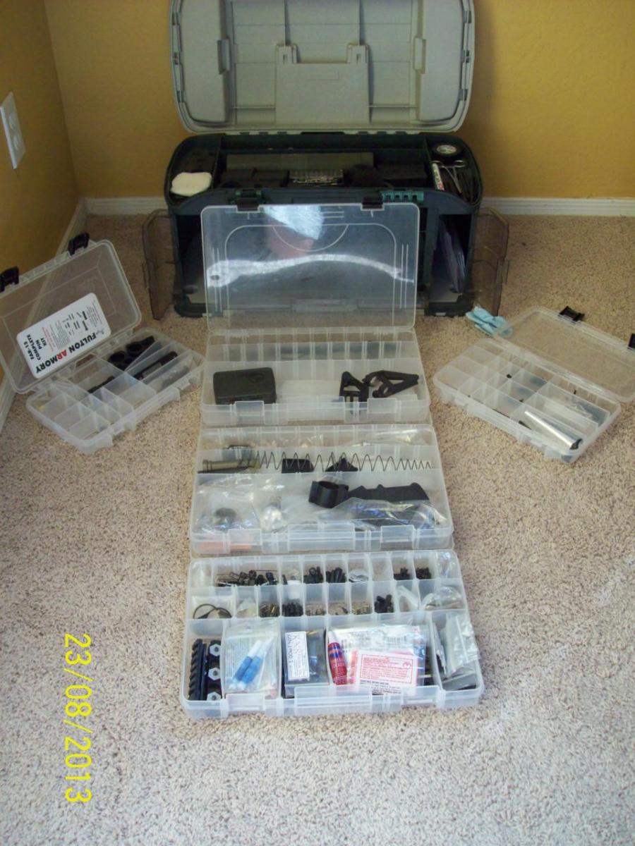

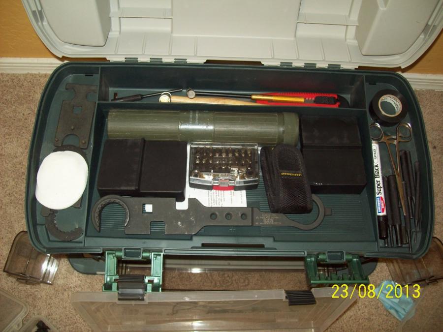

98Z5V Posted August 23, 2013 Report Share Posted August 23, 2013 Pat, didn't want to go through the pain of finding that pic, so I got a few more. I like your box layout better than mine, but they didn't have anything like yours when I was shopping. That's a good one that you found. Here's my junk... Quote Link to comment Share on other sites More sharing options...
