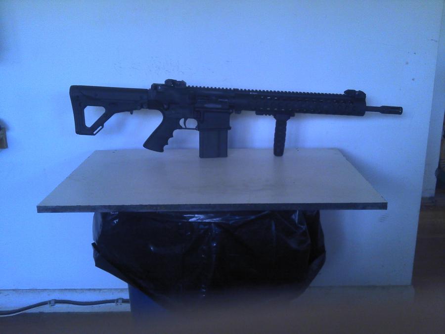

Magwa Posted April 9, 2014 Report Share Posted April 9, 2014 even empty and no glass it weighs the same as a stock DPMS carbine there is no light weight version with a med contour barrel S&W makes the lightest AR308 I have held in my hands and it is just 10 oz lighter than mine....you hang all the crap on it and then you will be asking yourself if I have to run and gun how the hell am I going to carry this thing... I carry mine on a vickers 2 point combat sling hanging in front, or I carry it by the scope use it like a carry handle when in thick brush. after a 10 mile hike I am asking myself the same questions..... Quote Link to comment Share on other sites More sharing options...
